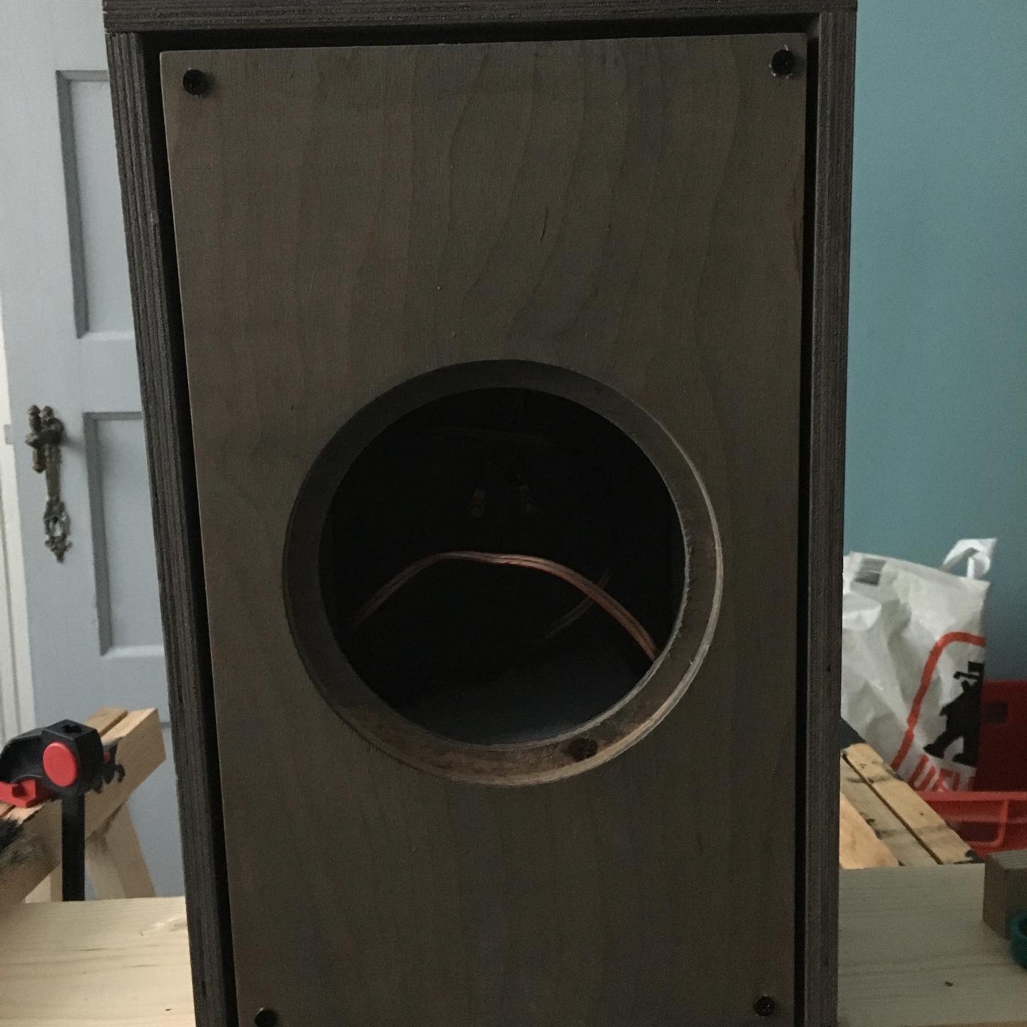

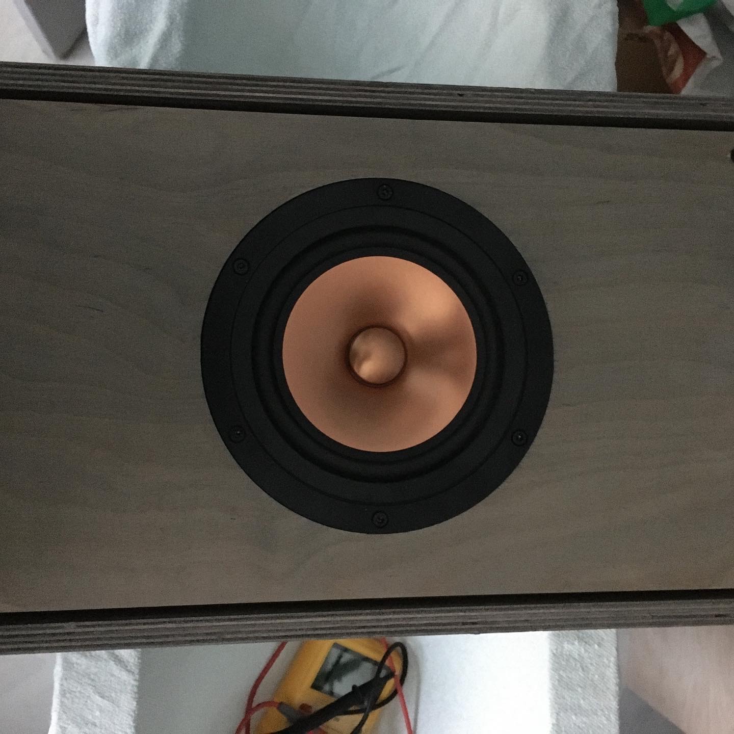

I did it with 10M Gen 3 in 11.5L sealed. I build the boxes following the BBC principle (thin plywood walls, but damped with bitummen on the sides and top and bottom, front and backplate are 18mm ply that is screwed with a rubber seal between the plate and the box). It does sound way better than the 18mm ply 27L vented box i had before, even without a sub (but not much below 50Hz altough). I use them with a very low tuned 150L vented sub with a Scanspeak 26w/8534G00 but i'm building new sealed subs with the same driver (it's actually fit for that). But i crossover a bit higher (250Hz at the moment with a 1st order passive serial CR). The port i had before disturbed the sound of the stack as it was tuned to 40Hz, and that is in the passband of the woofer so... Sealed it sounds more defined and punchier than ported.

Most of those speakers are ported altough. I tried it sealed, but with a solid wood frame inside the speakers that brace the thin wall cabinet.
Edit: added some pictures
