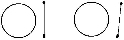

I have recently bought a second hand Grace G707 to mount it on my Thorens deck. However, mounting distance for the Grace is 222mm against to 215.6mm of the TP-16mkII, the original Thorens tonearm. Due to the shape of the sub-platter around the arm-mount, I have to rotate the arm in order to mount it 222mm away from the spindle. Which means that when the arm stands, it won't be tangential to the platter. Is this ok?
If not, the only solution I think of is building a new plinth.
I'm not sure what you mean but the arm to spindle distance is designed to be 222mm. This distance combined with the angle of the headshell will give you the best tracking performance. Assuming the cartridge is properly alligned that is.
If I remember the overhang for this setup is 18mm meaning the stylus tip will be 18mm further past the record spindle. This gives you what is called the effective length of the arm as 222 + 18 = 240.
My memory is fading so someone correct me if I'm wrong.
Bottom line is mount it at 222mm.

busoni said:What I mean is mounting the arm at 215.6, instead of 222mm. Would this be ok?
Then I would increase the overhang as much as possible to approach the effective length.
No.
If you reduce arm mounting length the actual arm becomes too long.
The problem becomes can you move the cartridge far back enough.
(The overhang 15mm (237 minus 222) does not change much)
If you understand arm geometry its not that intractable. Only when
you want the cartridge parallel to the headshell in the middle of the
headshell for the arms designed geomtery does the arm mounting
distance exactly matter.
Reducing arm mounting distance reduces the required effective
length and changes the optimum angle slightly (gets bigger).
What matters is getting a decent 2 point alignment within the
range of the headshell slots - cartridge angle does not matter.
Also note you can always set a null point near the record end,
what then is of interest is whether you get a null point at the
start of the record, as you move up and down the slots and
always setting the first point, the second one moves.
http://www.vinylengine.com/phpBB2/viewtopic.php?t=7141
Note that 15mm overhang is not part of the say Baerwald
alignment - its larger moving the cartridge forward which
would allow a shorter arm mounting distance (2mm or so).
# For Baerwald null points are 66.0 and 120.9 mm
# For Loefgren null points are 70.3 and 116.6 mm
Null points for the G-707 : 66.8 / 103.0 mm - not the best IMO.
Also I cannot see why the arm would not sit straight. You move it
backwards for the extra length and only sideways if you need to.
why twist it ?

stoolpigeon said:The 222mm figure is all that matters so your plan is fine.
I remember fitting a Rega RB300 (which has the same mounting distance) to a TD160 and having to file away part of the subchassis to get the correct position.
sp
I put quite a few 707s on Thorens TD 160, 165 & 145. The subchassis needed to be drilled/filed out a bit IIRC (it was 25+ years ago) to get the 222, but the grace came with 2 big washers that made mounting it up easy.

I cannot move the arm back and sideways because I have to trim the subchassis a little. I am trying to find a position without trimming but I doubt wether it's possible or not.
Thanks for your insights into arm geometry. I am not that familiar, but I understand that getting two null points is what matters. Anyway, I think I'll go conventional keeping the Grace specs. Actually I found some Rega mounting plate templates so I'll copy and build one of them as Regas have 222mm mounting distance too.
