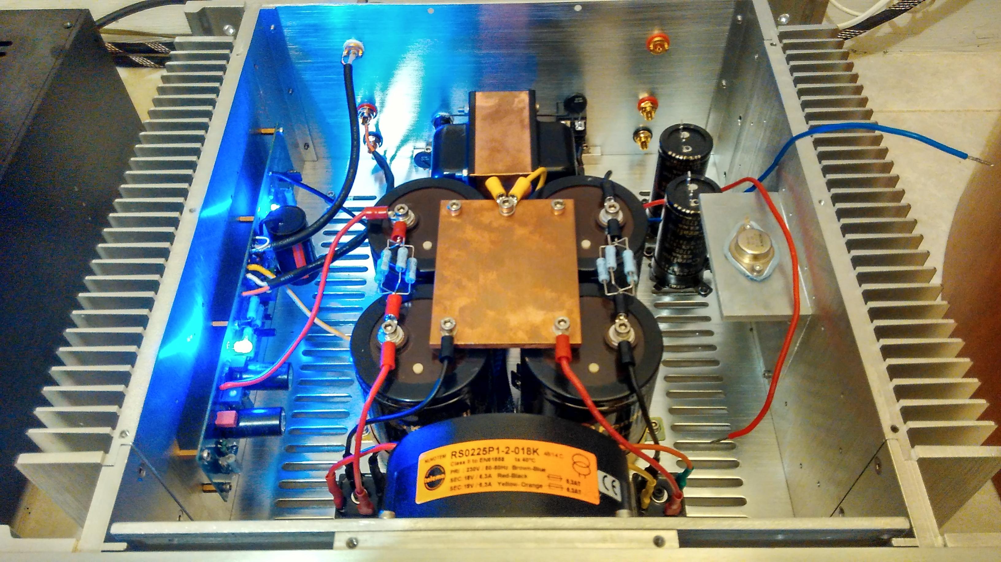

I have built a JLH class A amplifier (updated vers 2003). Now it is time to put the amp in chassi, Dissipante 4U 300mm from Modushop.biz (modushop.biz/site/index.php?route=product/product&path=207_277_279&product_id=220)
There will be one chassi per channel, ie in total two chassis (Left & Right).
Heatsinks are included in this chassi.
The power transistors MJ15003 is TO-3, in total 2 per channel.
Q: How can I best mount the TO-3 to the heatsinks?
Thanx in advance!
/Fartblind

No L-bracket.
Is the L-bracket a L-shaped aluminium profile?
How do I mount/attach it to the heatsink?
Look at the VFET amp thread, it uses the same transitors to-3 with similar case. Lots of pictures there.
