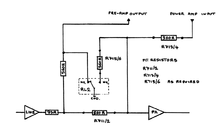

The tech manual for the audiolab clearly states that pre-out is not muted and therefore should always be switched on before and switched of after the power-amp. If your amp stars serial number 89xxx you MAY have approximately 8 second mute on your pre-out. If you pre-out mutes when inserting headphones, your amp will also have this 8 second delay.
The MA12 input does not seem to have capacitive coupling. Personally, I would consider using this on tube amps connected to the audio lab. Especially so if the motorboating stay with the left channel output of the 8000A and the pre-amp out and power amp in of your 8000A has not been separated as per tech. manual. Depending on serial number of the unit, the implementation of pre-out / PA-in seem to differ slightly between serial numbers starting 87xxx and 89xxx.
The output of the 8000A line/tone stage has two 35v rated electrolytic to protect the power amp from DC. However the servo of the power-amp will superimpose DC on the input and may therefore also produce a certain amount of DC on the pre-out of the Audiolab.
The MA12 seem to have it's own volume control - did you try to connect the source direct? If you use the 8000A only as RIAA and source selector, you could try to connect to the tape out and use MA12 volume control.
The Audiolab RIAA seem to have electrolytic blocking capacitor rated at 50V
