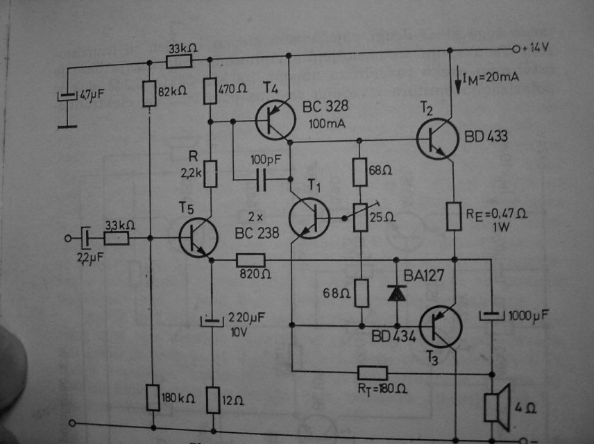

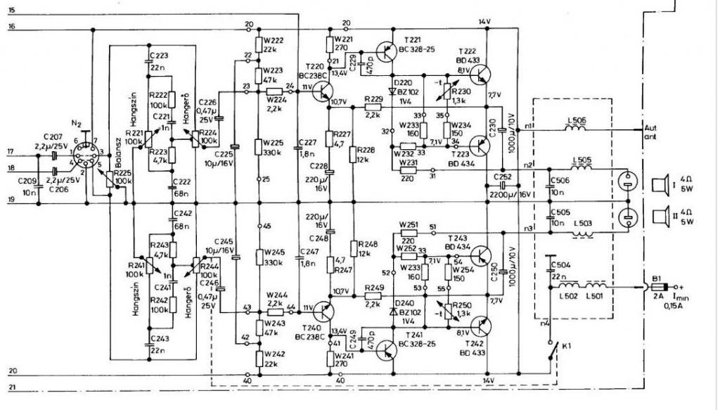

Hi Tiefbass !
I guess that you need amps powered from car or motorcycle 12V battery ,
here is some ancient schematics of low power but very very good sounding a/B class amps , newer generation BJT devices can be implemented with easy .
Best Regards
Best Regards
