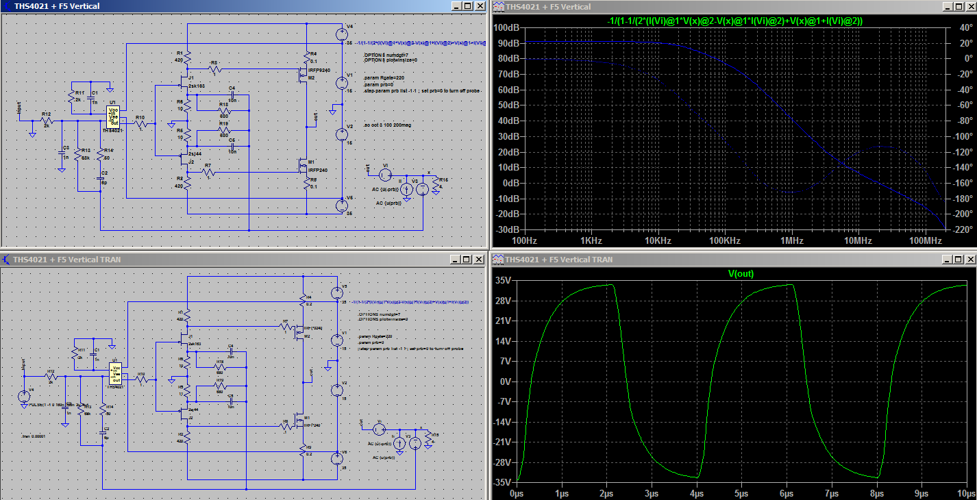

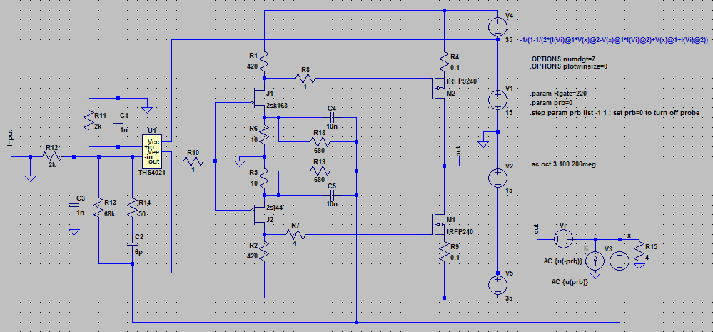

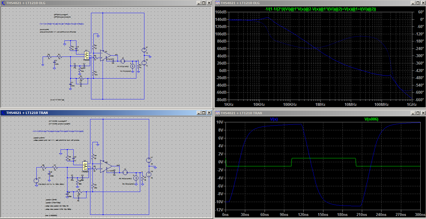

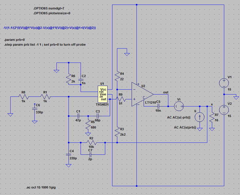

Brave one could try place low-noise high-GBW opamp in front of F5.
Doing this would provide not less than 90dB feedback depth through overall audioband with gain of ~35 times and unconditional stability with aperiodic step response.

Any non-inverting current-gain stage can be used inside an opamp's loop for up to ~14V output, then you must use current-gain stage with appropriate voltage gain. The higher voltage gain you could provide the deepeer feedback will be, but you must change correction capacitor values for stability and good aperiodic response.
Input resistance is better to keep not higher than 2 kOhm due to Johnson's noise. Overall scheme is inverting, so mostly immune to common-mode noise.
Input could be easy changed to balanced.
Supply are better to be well common-mode decoupled from AC mains for breaking ground loop through AC mains.

Yes, Papa, you are clearly right and hit the bull's eye!
But taking this exact as preference we could go even further.

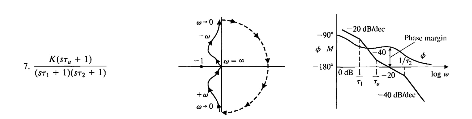

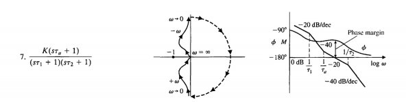

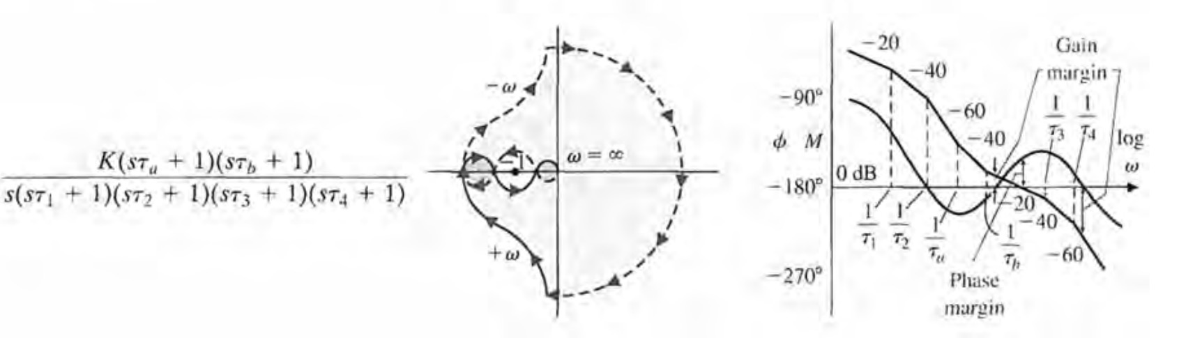

Carefully resolving common-case equation around two and four pole compensation we can estimate optimal pole and zero frequencies for audio-preferred aperiodic step response.
Here, for example, possible headamp with a gain of 5, input resistance of 2 kOhm and audio-optimized open-loop gain. All poles moved as high as possible, preferably upper than 20 kHz for providing +-flat depth through audioband.
First three poles provides very fast gain drop, then two zeros compensate gain curve for good stability around unity gain frequency and audio-friendly aperiodic step response, and then the last pole closes the curve.
Shown but not connected input filter have a corner around 80 kHz.
