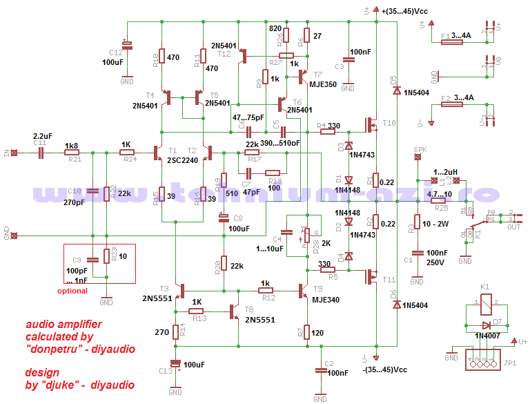

I calculated the audio amplifier.
With these values of the components to shematics ate amplifier works well or these values are only theoretical?
thank you and cheers!
Great work, I actually use different components and values in the input and VA stage, but using 2N5551/2N5401 is certainly an option.I calculated the audio amplifier.
Please keep me informed when the amp has actually been built and measured with these component values.

Hello Donpetru!
Since I see that you have a progam for the simulation of electronics circuits, so please if you are able to create a simulation of my audio amplifier, which I designed for this shematic (Figure 1F).
Big thanks in advance!
Hello Donpetru!
formula 22,
That diagram audio amplifier seems not optimized. For example, there is no point can mount only trim P1 in the input circuit of the audio amplifier. Right is to mount a resistor in series with the trim P1. But so, not 100% good. It's much better to try to let the resistance instead of P1, but that only after having established experimental optimum value of current in the input circuit. Bootstrap capacitor C8 is no current solution. It's old-fashioned, as is diagram audio amplifier. Then, R2 and R9 are too high.
Finally, if you want one audio amplifier diagram worth done, download and analyze all schematics (pdf files) that were posted in this topic or thread:
KIT 0205 - schema, modernizare, constructie amplificator - Comunitatea Tehnium Azi
Nice day.
Nice day.
