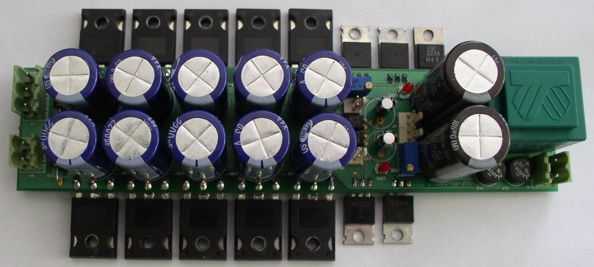

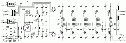

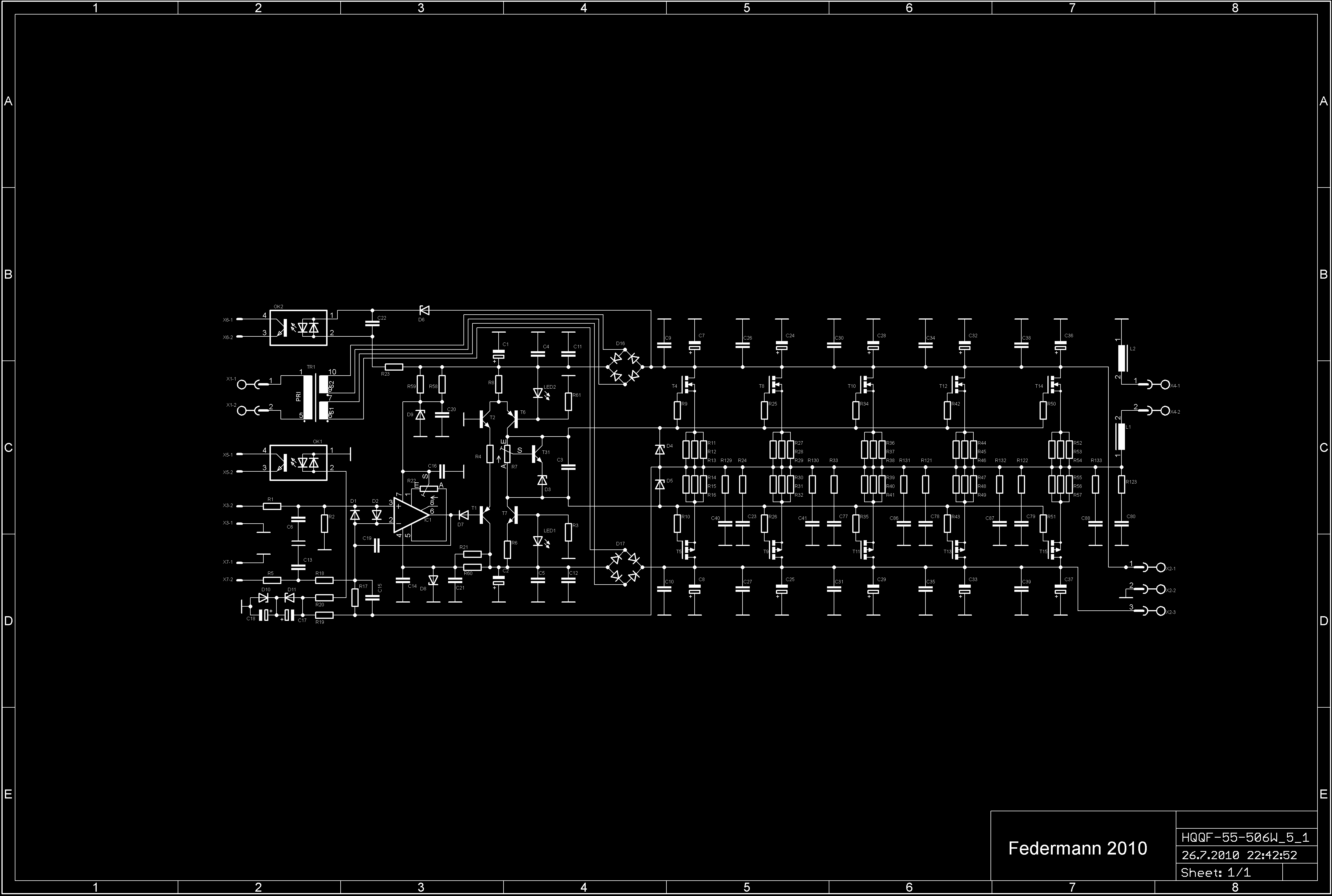

Amplifier HQQF-55-506_5_1 finalized
how do u do the 3d modeling .......... it is very impressive ...... which software......
and ur amp also looks stunning............

The other side
You have silkscreen printed over your pads.
Doesn't your board house remove silkscreen over pads on CAM import?
The PCB is double-sided, through-, two-sided solder mask, two-sided printing, gold, all Photographic method produces. Size is milled.
Soon there will be more pictures of the production.
