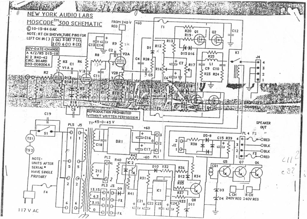

Anyone have a manual and schematic for a Moscode 300? Appreciate any help. Thanks.

Had trouble with the site, but got the schematic. Thanks Rayma!English would be nice....but if that's not possible, I can handle Russian and French...

i need worth of R34, R36,R37 and R39.

See the link Rayma posted...although it doesn't have a parts list showing values. No one seems to have a copy of that. Good luck.

Someone who owns the amplifier will have to make a BOM using the schematic.
Or, with clear, close photos of the pcb, I could do it. There are very few parts.

R34 620 ohm 2W
R36 2K7 2W
R37 270 ohm 1W
R39 68K 2W
The resistors get quite hot, i would use modern 5W Mox types instead of the 2W types.
