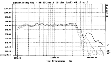

I have been looking at the CAW / EW / ECW 536 series of drivers. I have noticed that the cheapest (CAW536) has the most reasonable response curve, and thereby, less of a fortune spent on the crossover. The other two are significantly more expensive because of superior parts (apparently). Having said that, I have heard some pretty bad press about them... miserable distortion.
Have any of you experienced this? If you were left to your decision about these 3 drivers, which would you choose? At the moment, the cheapest one seems to be the best because the response curve isn't as much of a mess.

The cheapest Morel 538 with simplest motor looks easy enough. 8L reflex with Qts 0.38 actually. But 7L is hardly a big change.
I suspect it will work well enough with a 4kHz crossover (3.3uF and 0.3mH and some resistors at a guess) to a second order tweeter. Maybe just a simple 1.5mH bass coil.
Maybe that big 3" rubber dustcap has some issues, but Morel don't build rubbish. Most people like them.

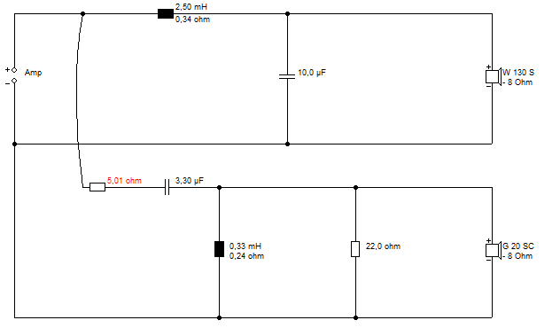

I had a look at various filters.
This one doesn't do it for me. An LR2 design works better, and red resistor is your tweeter level. Or the simpler bass coil and second order tweet used in the original KEF Cresta.
