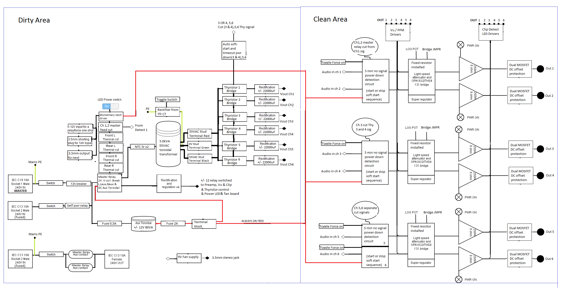

First attachment showing over all architecture. Fundamental functions are as follows:
I don't think I'm going to bother with bridging or Lightspeed attenuator as it doesn't seem necessary, may implement in the future if required. I've chosen not to put anything fancy like a micro controller in as I like the simplicity of it being a big dumb powerful amp with exactly all the control I want.

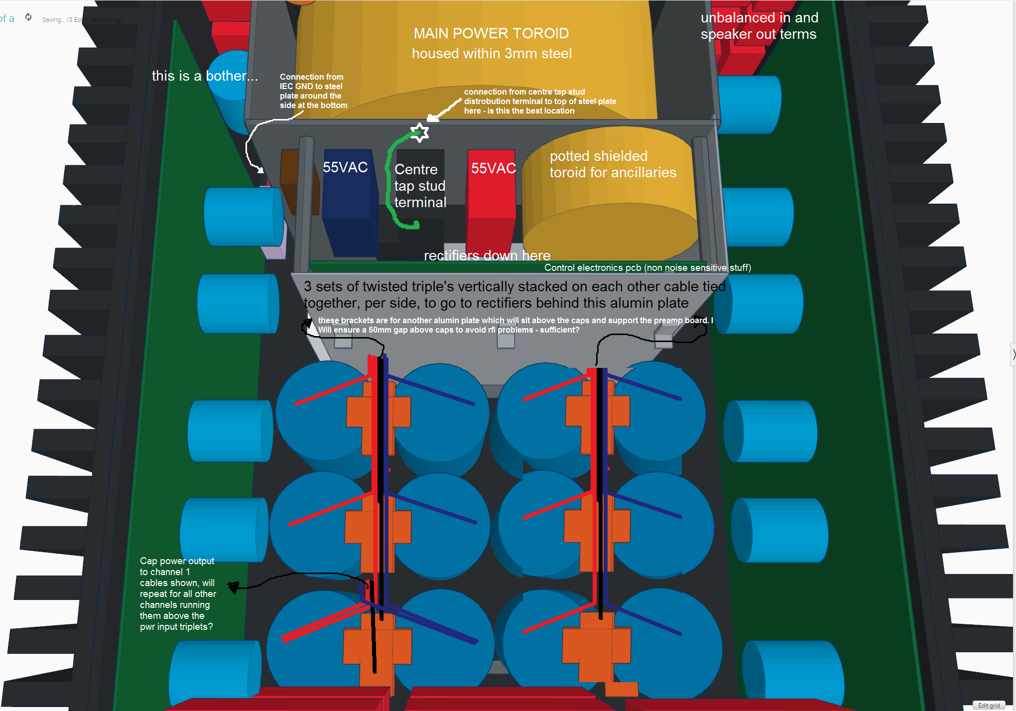

Second attachment showing CAD drawing in Tinkercad. I highly recommend this website for quick modelling although there are constraints. The greatest being when it came to marking up panels to drill the script won't give you centre's from an origin of any object. The drawing is a bit out of date now but most of the stuff is there.
- 6 x 250W output into 8 ohms with near enough perfect doubling of power into 4 ohms
- Independent high quality power supply comprising of 53400uF per channel derived from one large 5kVA transformer.
- Master and slave switched IEC inlet IF more power is ever needed when used as a PA amp etc
- SSR Relays for output and protection switching.
- Power saving Thryristor bridges completely shutting down channels independently, based on a timeout.
- Remote and pass through switching to be used as part of a rack.
- Super regulator circuits for all preamp circuits.
- PPM and clip monitoring for each channel.
