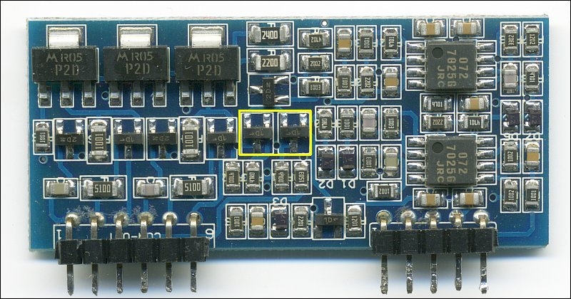

Post a photo of the component-side of the board. If it's using the driver board below, the two transistors in the rectangle are likely suspects as well as the op-amp closest to the top of the same board.

That appears to be the same board that is in this amp. How can I test these components to verify if they are functioning optimally or not?

There's really no way to test them. The transistors sometimes check good with a multimeter but will not function well enough in the circuit. These typically cause the amp to go into protect. The op-amp can't be checked. When it fails, the amp often seems to work but won't produce audio.
