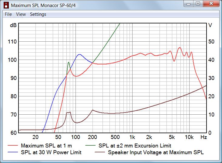

The thing is: I want to build a small battery speaker for indoor use (and sometimes for outdoor use). So I ordered two Monacor SP-60/4 woofers and the Dayton tweeters based on Saturnus' (old) recommendations (later I heard the quality was less than before, but hey, I am no audiophile and anything better than some car speakers will do).
I was planning to put them in a box with two separate compartments of 4 liters (net) with a small 3.5 cm BR port (2x). So far so good.
I plotted this in WinISD using 15 W for input (TPA3116 for amp) and the cone excursion goes over the Xmax of 2 mm around 100 Hz and way over it under 60 Hz. Wouldn't that be a big issue? And why would Saturnus (and others) recommend such a thing as it would break the drivers? I guess I must do something wrong, or I misinterpret something.

So now I understand how to wire the woofers/tweeters, but still don't know why a setup is recommended (for example here and here), while according to my WinISD plot (and interpretation) it would break the woofers. And as guys like Saturnus ar far far far more experienced than me, I am pretty sure I must be doing something wrong. But what?
Your result is correct. A small woofer like the Monacor SP-60/4 exceeds the excursion limit quite quickly. There's not much you can do against it except ignoring it. That's what usually is done.![]()
Haha, thanks. That's what I will do then: ignore the crap out of it
