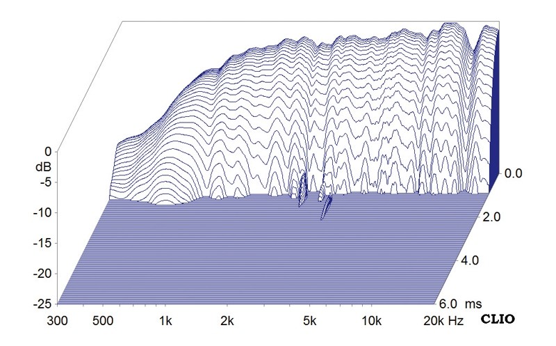

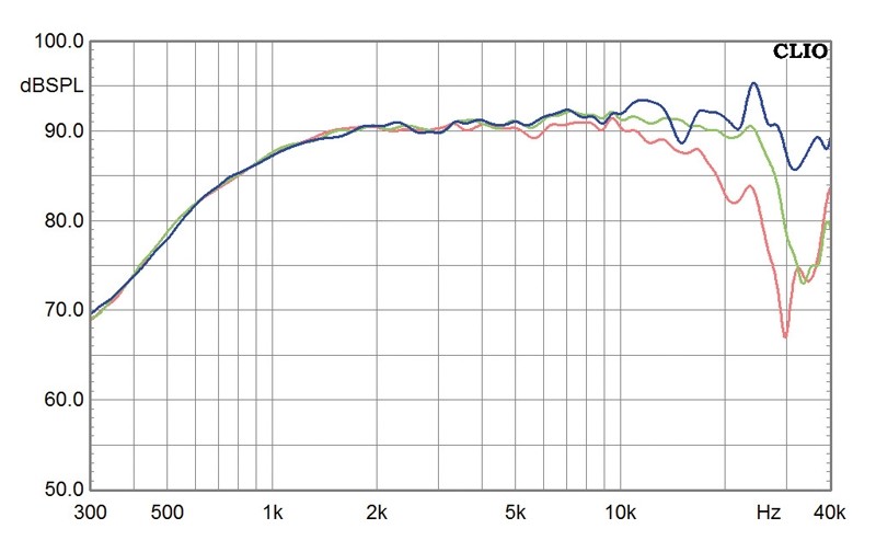

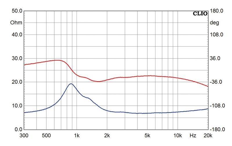

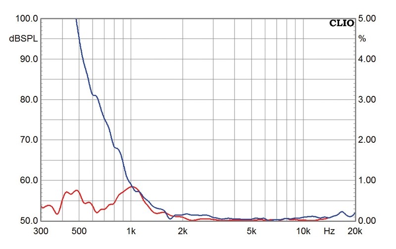

I do not know why went so unnoticed.. there is only few tweeters which can be used below 2kHz, and this one looks very usable..
https://www.monacor.com/en-us/monac...y/speaker-technology/hi-fi-tweeters/dt-350nf/
Measurements are essential..Good find. Can't see any reviews online for some strange reason.
Klang+Ton and Hoby HiFi 1/2014..

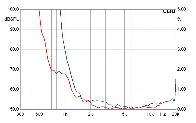

Good tweeter, also have small distortion even below 2kHz..Similar could be built with Dayton RS28A-4..

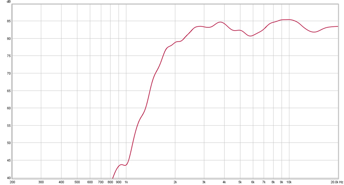

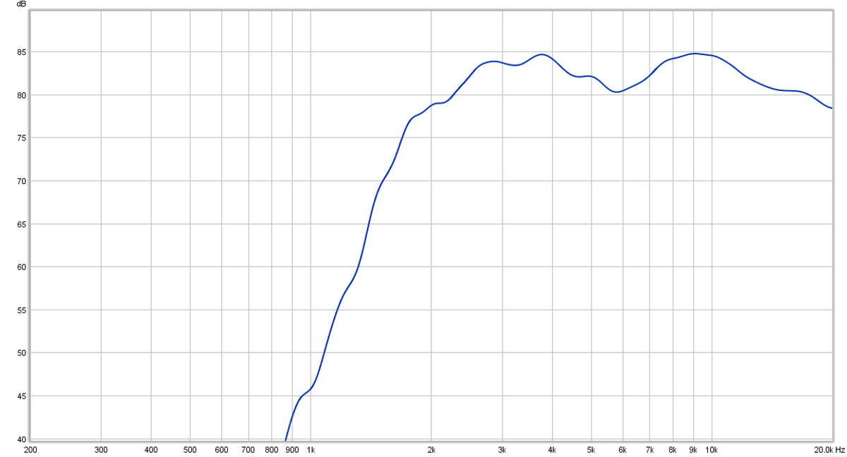

I waited one month for answer from Monacor 'loudspeaker expert'.. yesterday he said that tweeter is in defect..

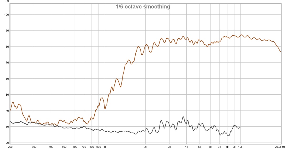

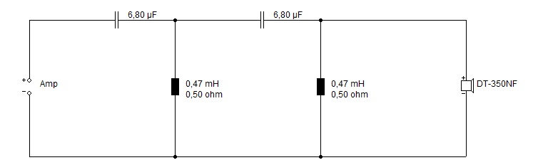

Drivers are measured without front panel, on air, with identical xover and distance (1m).. there is very small diference from 5 to 8kHz, and not so small from 8 to 20kHz..The Measurements that you sent me are not very meaningful.
My question was is that normal or not..

First thing that cross my mind was damped coupling volume for a low resonant frequency.. maybe damping can make that difference..The DT-350NF was one of my Babies and I have developed this Tweeter in Cooperation with the german manufacture.
In the past we have no Problems with this tweeter about dispersion in the serial production..
Second was double magnet system with drilled pole core.. tweeter with worse frequency response above 8kHz have outer magnet 1-2mm eccentrically mounted.. but I don't think that can cause problem, maybe damping..

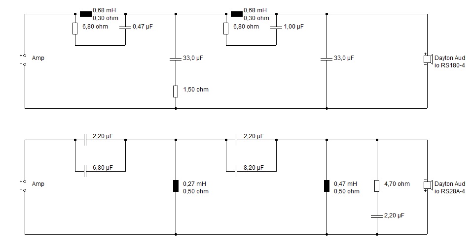

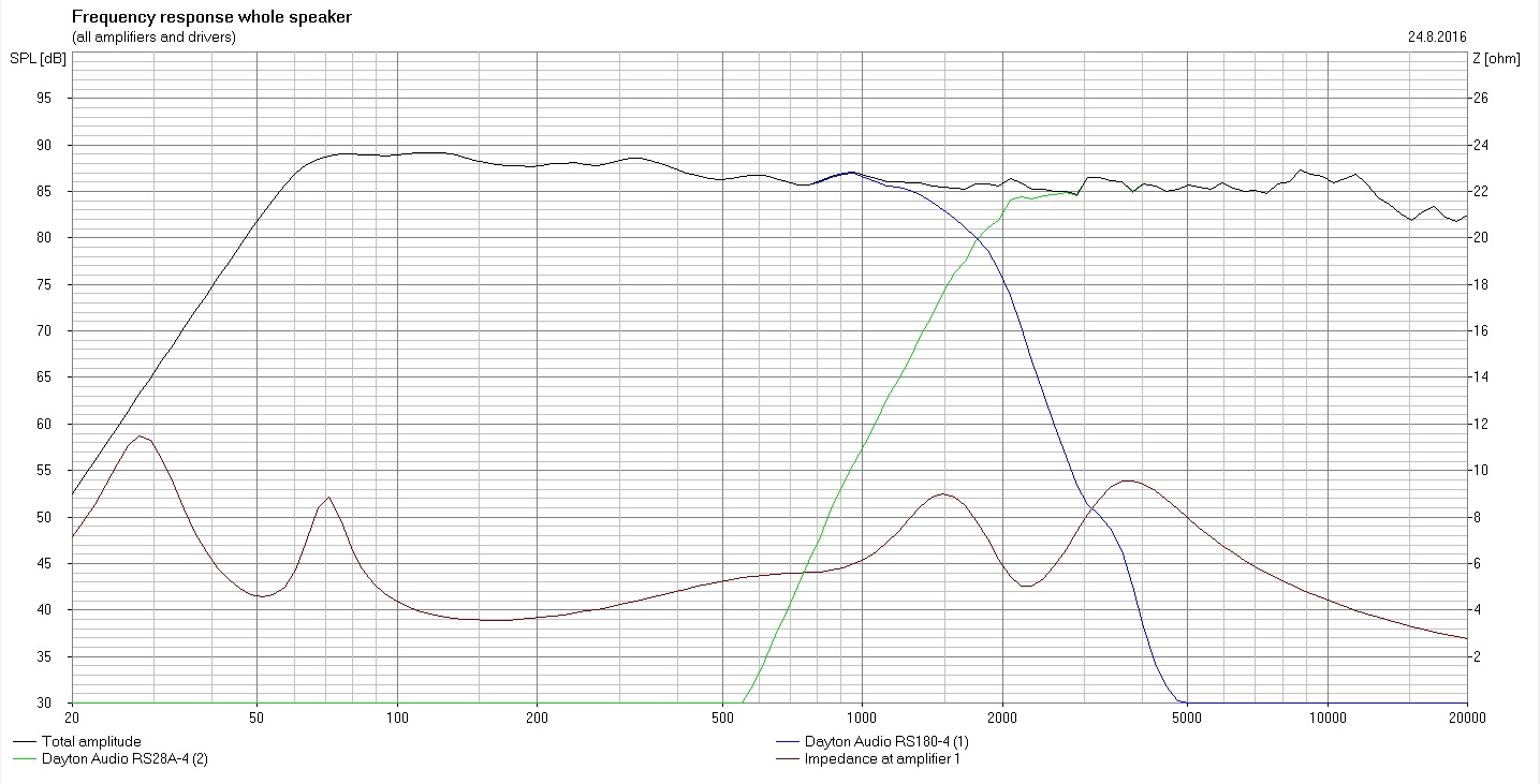

Now I'm thinking about RS180-4 and RS28A-4..Similar could be built with Dayton RS180P-8 and RS28A-4..
