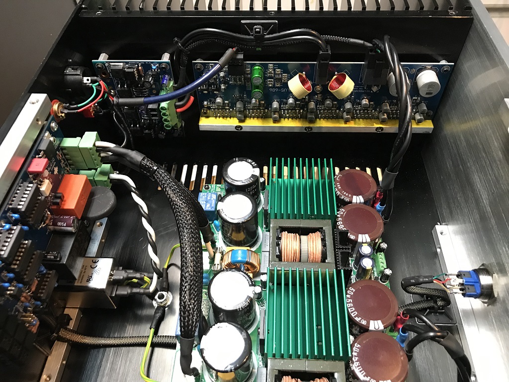

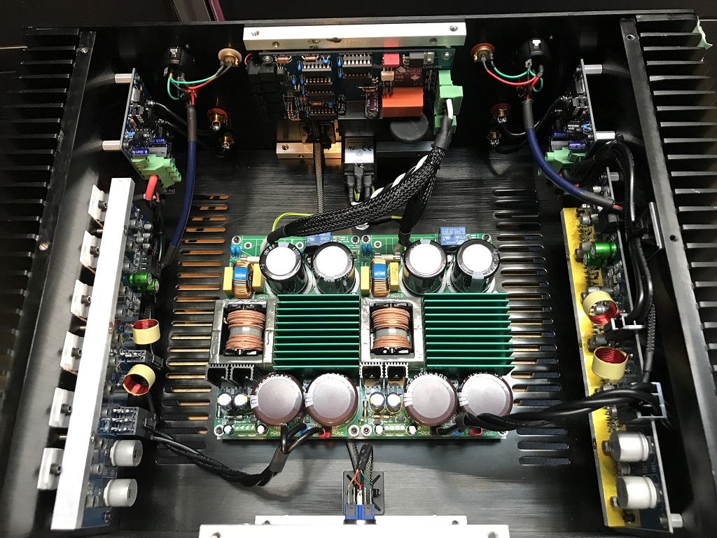

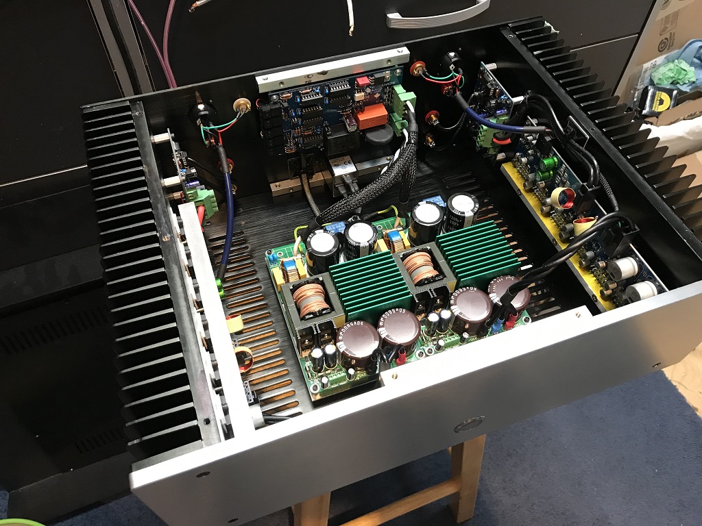

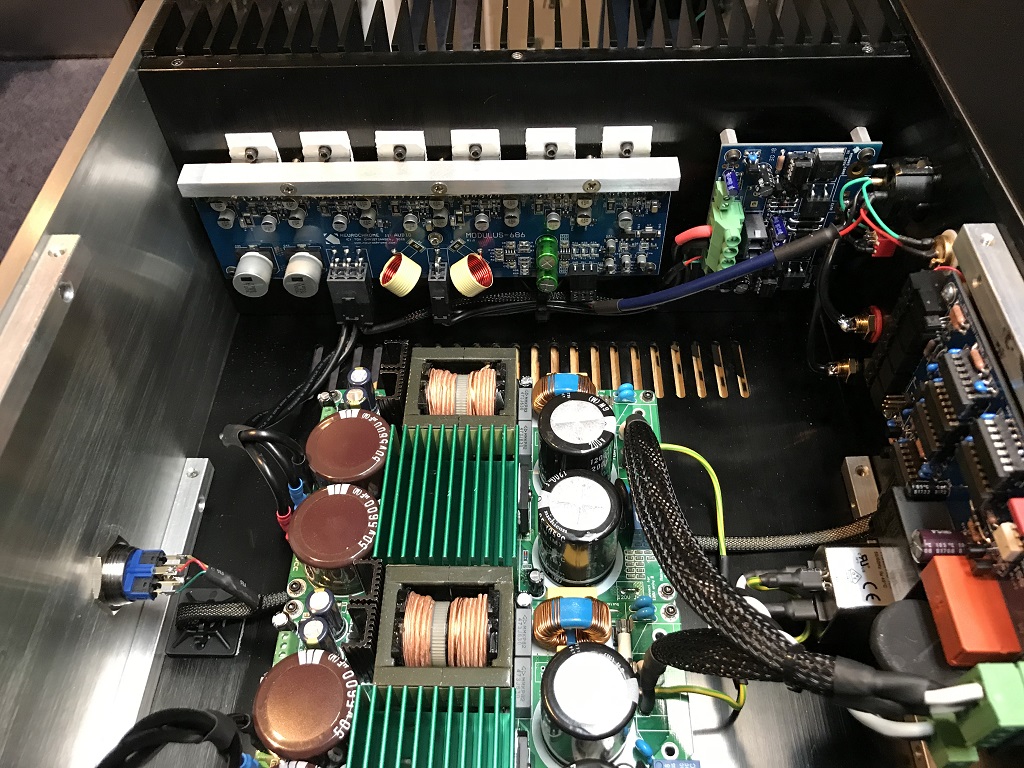

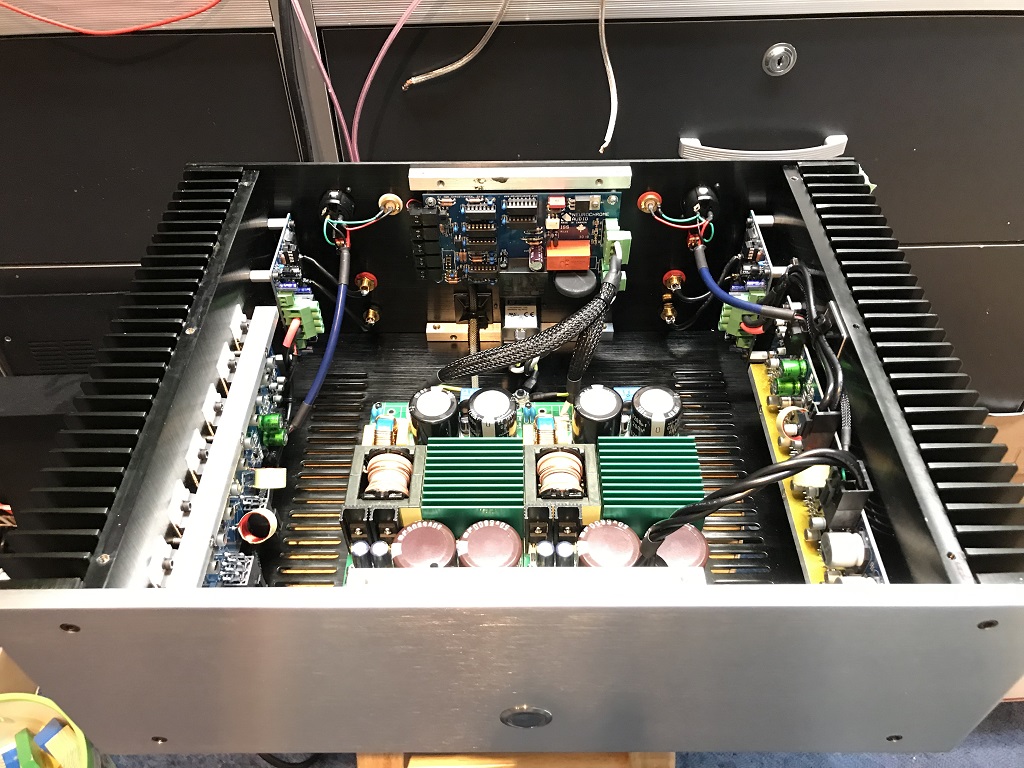

Here's a few pictures of the completed build. I have tested a few sine wave in unbalanced mode, from 10Hz to 120KHz with 1V and everything is clean. Square wave stays pretty sharp until a little over 20KHz but I'm guessing the power supply is probably the issue and using balanced signal it would be better also.
I also tested with some music on my test speaker (very cheap speaker). This week will be connected to my main system.

Hi Do,
good job! May I ask why you mounted one of the boards upside down and the other one not? Is it just for optical symmetry?
As far as I know, it is always better in terms of cooling efficiency to have the power devices next to the heatsink's bottom edge?!? I suspect the LM3886's at the left handed board will get hotter at the same load than the other ones.

Hi Kay Pirinha,
It was not done for visual but for keeping cabling distance as much as possible the same length. The position on the heatsink is not that trivial for a Class AB, B, since when the heatsink gets the heat spread after several minutes, they become the same temperature. There's not enough heat being dissipated through this amp with the size of the heatsink and it is spread in a good length on the heatsink. I would do different with a Class A amplifier.

Nicely done, Do. I love the tight and clean wire runs and the use of Tech Flex. Your way of mounting the Guardian-686 boards to the heat sinks is my favourite as well.

Do, to reiterate Tom’s words - very tasty layout. Any concerns about long term heat degradation to foam adhesive on the nylon zap strap saddles attached to the heat sinks?

I have these foam pads on Class A amplifier heatsinks for several years and so far they're still holding in place. One can always remove the foam and put in the 3M VHB instead.
