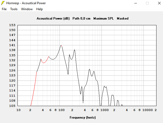

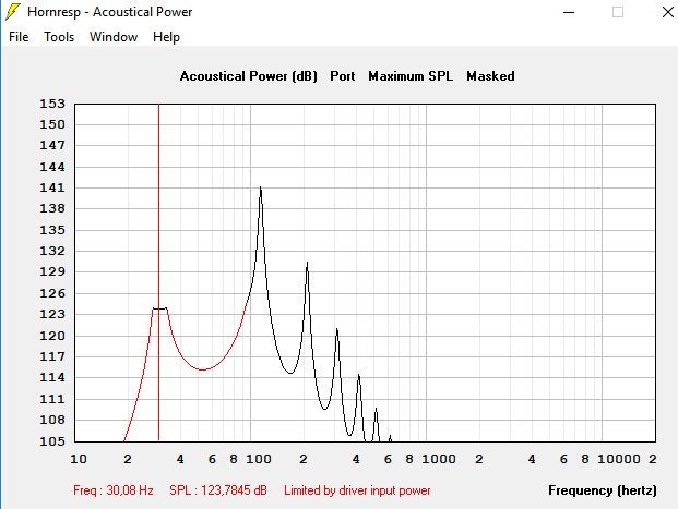

'better driver' is nearly impossible. I'm gonna be using the Lavoce San 214.50, which is arguably the best sub at that price. I might upgrade to an IPAL21, but those have specific amp requirements which I can't meet at the moment.I'd go back a step. What's the application where you need such a large subwoofer to be portable?60 x 60 x 120 is smaller than 90 x 80 x 60, which is the size of the Ricci designed Skram, which is what I'm gonna modify to fit my size requirements. A lot of space is taken up by the horn and the large ports to allow high output.

With this design I can have 130db down to 30hz (in half space!) , for around 1000 euro for a pair (including amplifier).

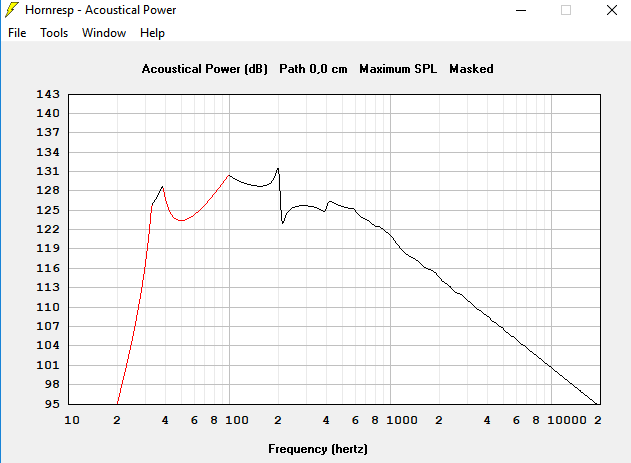

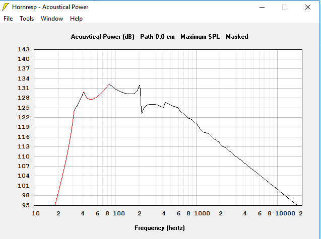

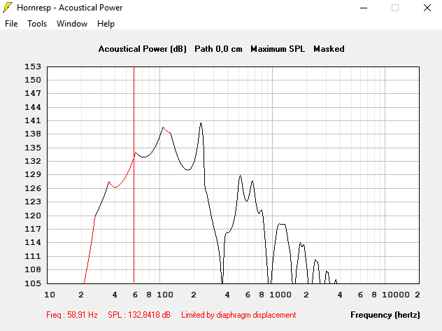

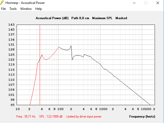

I actually want something more complex. Just for the sake of it. Using this Skram-like design also has it own advantages. Also, I modelled those RCF drivers, and youre right thy perform very well.
The RCF 15" in a 30hz tuned box (exactly half the size of my design) can only match my design when 2 are coupled together (so 6dB boost) when using a small port (which doesnt take in to much space) which results in an incredibly high port velocity (over 80m/sec).
When designing the cabin to reach the same velocities as my design the output decreases by a lot, as seen here:
Other disadvantages are an increased price over my design (depending on the store around 20% more for 2 instead of my x1 21" driver) and more amp requirements (3000W vs 1700W for mine)
In all, if I'm trying to reach as much SPL as I can at 30hz, than my design is gonna be hard to top. Using x2 18" drivers in the same 60x60x60cm cabin as the RCF model, then the results only get slightly better, and still very away from mine. With x2 18" the price also skyrockets, as well as amp requirements.
