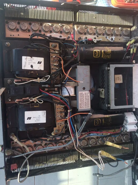

Hello ..I want to modify my amplifier crown 2400 wich work with 110v 60hz in 220v 50 hz.
I want to know what value is the voltage supplied transformers and voltage relays on the board . on the internet I found something interesting. Many thanks and look Answers😡

The 120 Volt 60 Hz version, sold in the United States,
is not voltage selectable. It does not have a voltage
selection board. This version is to be used only with
120 Volts and only with 60Hz.
All other versions of the Micro Tech 2400 use a voltage
selection board. The chart, in the manual, indicates
different configurations of jumpers for different voltages.
Note that the circuit breakers, fuse and
transmotor may need to be changed to accommodate
different voltages. Versions with the voltage selection
board may be used at 50 or 60 Hz.

You will need;
D 8631-0 Power Transformer (Universal Volt) 2
C 8041-3 Circuit Breaker, 7.5A (200V-240V) 2
A10285-7 Fuse, .5A AGC (200V-240V) 1
H43408-6 Transmotor (200V-240V Only) 1
to make it work anywhere other than USA.

i know what i will need..but i need the diagram from power suply because i want to put transformer for 220v and i don t know the values of power suply(voltage for rectifier and voltage for relay).thank you for help.😀

i resolve the problem about power suply..when put the power suply 1 chanel have the green led On and ODEp OFF and next chanal have only the ODEP led on..where is the problem.What must to chek?the output transistor?
Hello to everybody!I solved amplifier ,i replaced all power transistor and pilot transistor.i biased booth channels and now is working very fine.Now i use a 220v to 110v transformer.I bought one crown macrotech 2400 EU version and this week i want to make conversion.i have transformers,cooler and breakers for eu model..i will post pictures during conversion.😛😛
If your 110V amp using two separate power transformer for each channel, then you can wire both 110V transformers in series to form a 220V amp and no need to use an extra AC conversion transformer.
Please don't try this.
If you are only using one channel, its transformer will pull current and the other won't. The not running channel will then see more than its rated 110V
The same principle will apply if the channels are not running at the same power output

Brian is correct and beat me to the punch.
Terrible idea, the voltage across the primaries will vary as the level of power between the two channels varies.

with this Crown ground topology i don t know if is oke to mount primary winding in series.And also cooler fan is for 110v.I bought this Crown EU version and i will mount both transformers ,breaker and cooling fan.i will attach picture here with all operations.Thank you.!
Since this is a high power amp, the output load will be big different in different channel, so that the primary load of each power transformer will be different, so that it is "not suitable to connect the primary in series for 220V"
