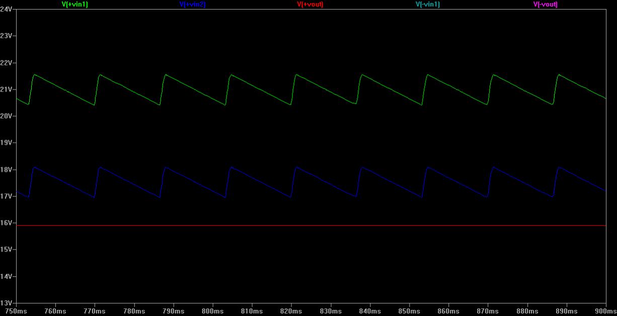

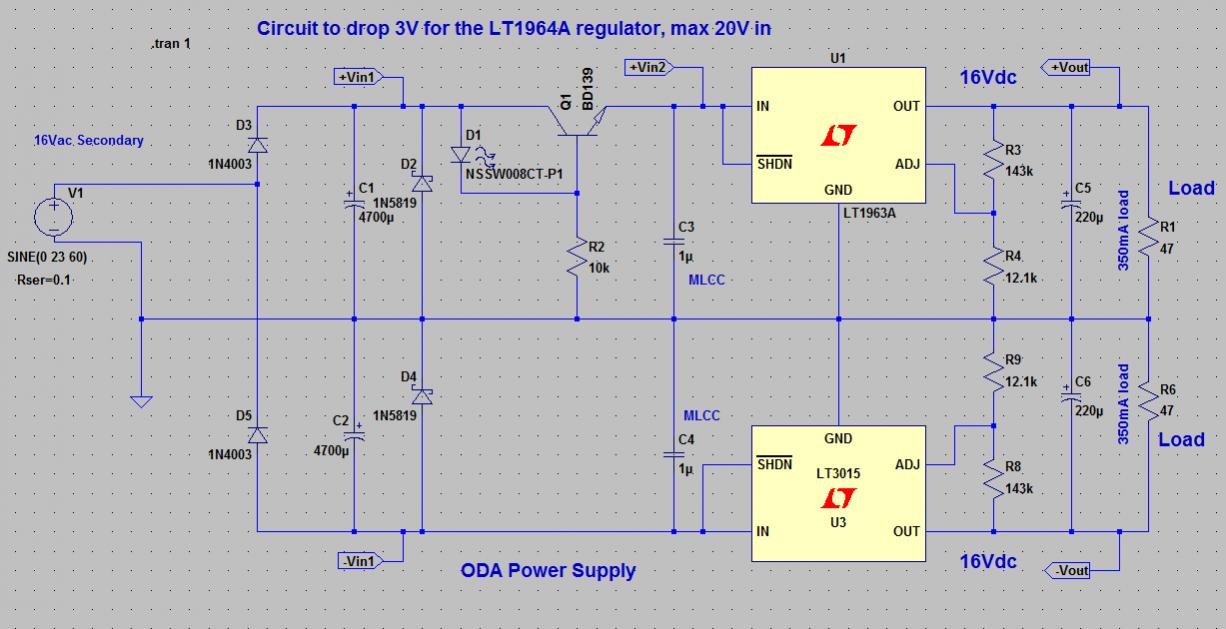

There is one small hiccup to watch out for if you wind up using the LT1963A and LT3015. The maximum input voltage on the LT3015 is -30Vdc while the LT1963A is only +20Vdc.

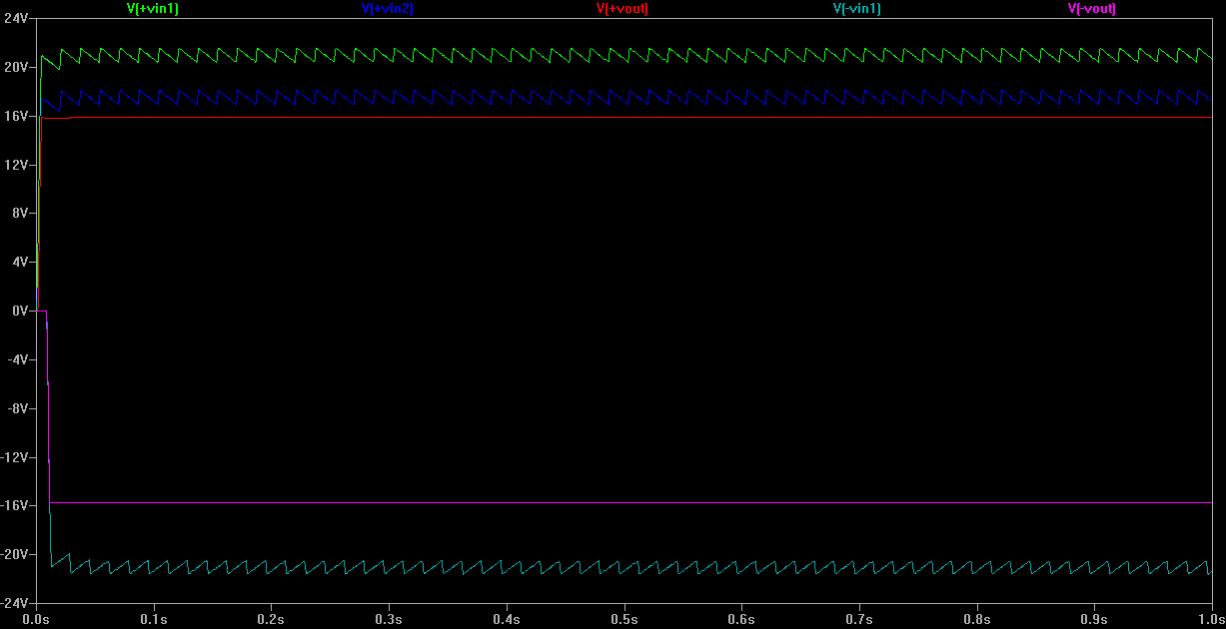

I'm doing a design and layout right now with both parts being fed by a 16Vac half wave and I want +/-16Vdc out. That results in the incoming ripple going from 20.5Vdc to 21.5Vdc, too much for the LT1963A but OK for the LT3015 on the negative rail (-20.5Vdc to -21.5Vdc). So I borrowed the great idea that pete_shumacher recently posted here for his power filter of a diode (LED) drop from the rail feeding a series pass to drop 3V of incoming voltage for the LT1963A. So now it gets ripple that goes from 17.0Vdc to 18.0Vdc. Problem solved. 🙂
You can use the LT1963A to regulate a higher voltage -- just use it to regulate a portion of the output voltage a la Maida. I did this with a DH-110 preamplifier to replace the LM317/LM337 which regulate a discrete preamplifier. The output impedance will be different, however.
You likely want to add 10 nF capacitors from the ADJ pins to ground: Linear's data sheets indicate noise output is lower and transient response better with those in the circuit.
Thanks for the heads-up! I did forget those caps.

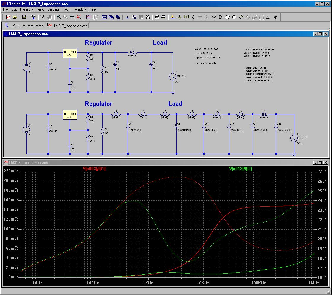

Previously, I came back to the LM317/337 again and again for one reason or another.

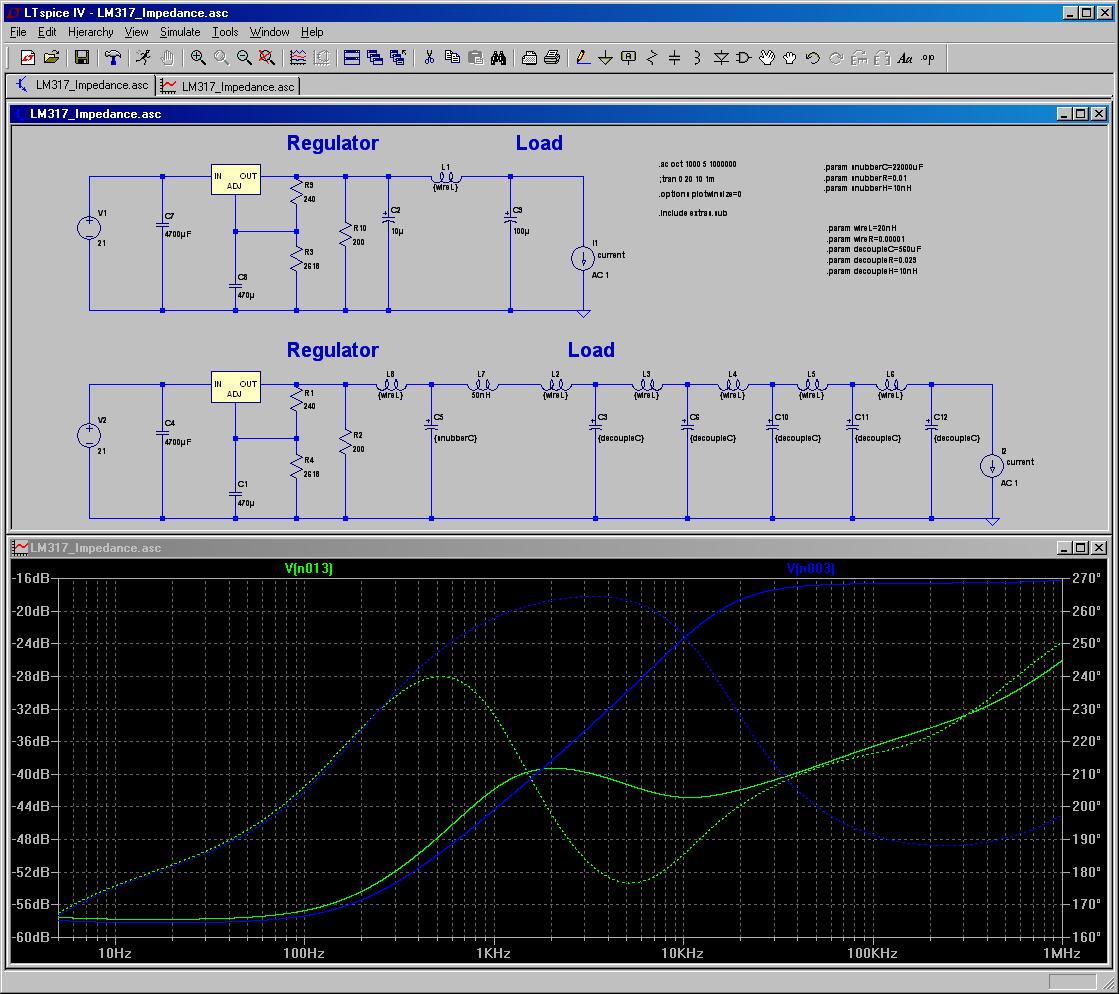

Attached are the schematic and simulation of my alternative ways to implement it. One graph is in ohms, and the other is identical but in dBs. The red curve is the standard implementation, and the green curve is the alternative implementation.
The idea is that if using LM317/337 we have no choice but rely on using capacitors at higher frequencies. So let us put some small, miniature type, low impedance electrolytic capacitors near the opamp legs. In that way we don't need to worry about film capacitors. The lowest impedance caps I found was Rubycon ZLH 560uF/25V dia=8mm Z=0.029R. This size is not too small but is small enough to be still manageable. Smaller size caps would have higher impedance, and bigger caps would be too large in physical size. These caps provide a lower impedance at the load. Of course, they would create a large, nasty peak in impedance within the audioband. The fix is to install a snubber at the regulator output. The capacitor required for the snubber is very large. We need to find the right capacitor with the right amount of ESR here (0.01R is ideal).
Comparing to the standard LM317/337 implementation, this alternative is much better. The standard implementation assumes Cadj=470uF, Cout=10uF (ESR=0.5R), Cload=100uF (Z=0.2R). If R(Cload) <0.18R or much larger than 0.2R there would be an impedance peak in the audioband. The alternative implementation has an impedance no more than about 10mR up to 20kHz, and no more than 20mR up to 100kHz.
I use opa627. It has a PSSR 78dB at 20kHz and 64dB at 100kHz. My way of implementing the LM317/337 provides 42dB at 20kHz and 36dB at 100kHz, combined with the opamp PSSR I have basically 100dB or better PSSR right up to 100kHz, which is not bad. There is no signal above 40kHz. So noise above 100kHz can be dealt with by using passive components before the LM317/337 regs. A small inductor of 47uH in a CLC circuit would deliver very good noise surpression result above 100kHz.
But then a regulator can never be good enough for audio. So I am still curious about finding a better regulator to use.

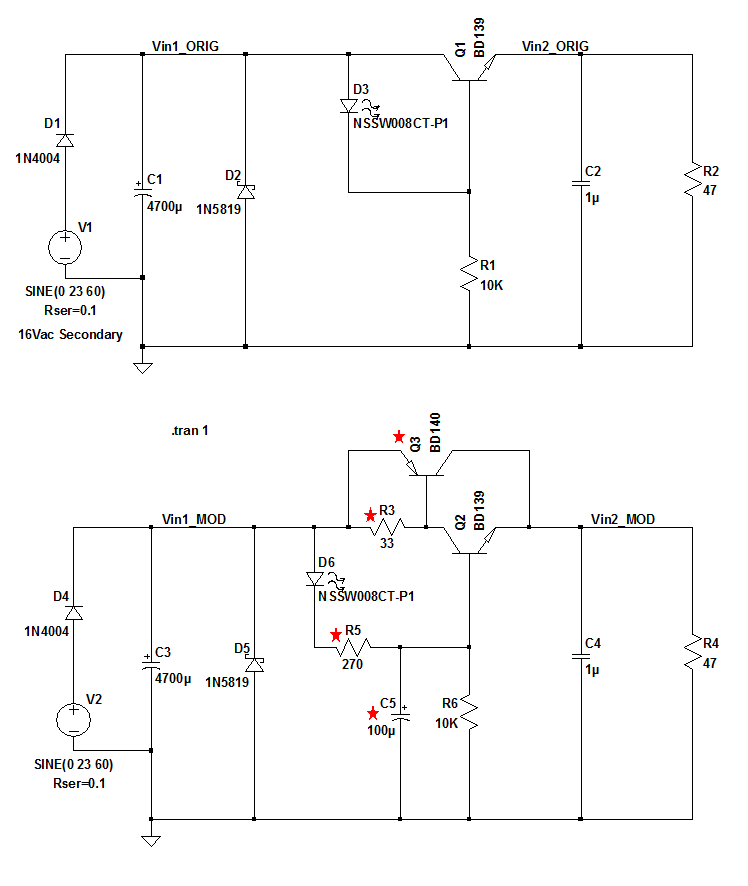

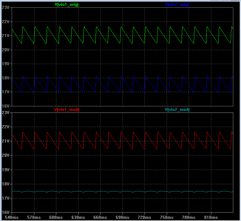

agdr, I did a side-by-side simulation of your original schematic (top), and a modified version (bottom). The modification added four new components; they are marked with red stars. Simulation results show the same average DC voltage on the "Vin2" rail, but quite a bit less ripple.
If the LT1963A attenuates ripple by 560X (55 dB on the datasheet), then less ripple on the input means less ripple on the output. OutputRipple= (SMALL / 560) is less than OutputRipple= (BIG / 560), it seems to me.
Indeed why not place a similar attenuator into the other, negative, leg of the supply as well?
