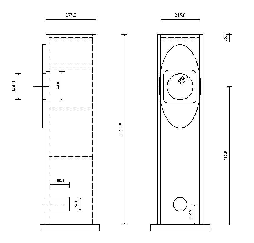

I am building a ML TL with the fullrange 6"speaker from Fostex FE 167 E.
The dimensions will be height= 40" depht= 10 1/2' and wide = 8 1/2 1" and a port which will be round 3" and 4 1/4" long about 1 1/4" from the bottum
BSC will be L= 2 mH and R=6 ohm.
And most important no stuffing

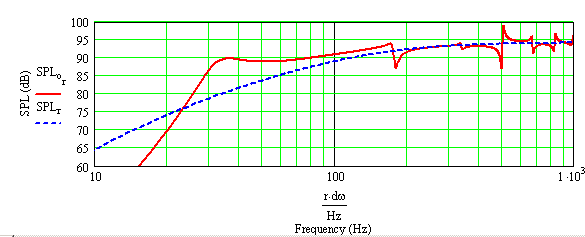

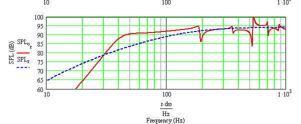

Dave Jones said:I modeled it with Martin's software. Here's what the FR graph looks like with no stuffing. Are you sure this is what you want?
[Added later: Are those inside dimensions? I assumed they were.]
If I assume OD, here's what it looks like:
Here is the link to the actual project with measurements: http://geocities.com/rbrines1/Pages/FT-1600_MkII/Design_Details.html
rbines wrote this:
The MkII version is an evolutionary improvement upon the original design. Over the three years since I published the original FT-1600, I have tried to improve the mid-range presence by reducing the amount of stuffing in the cabinet
So in his mkII version there is almost no stuffing !!!

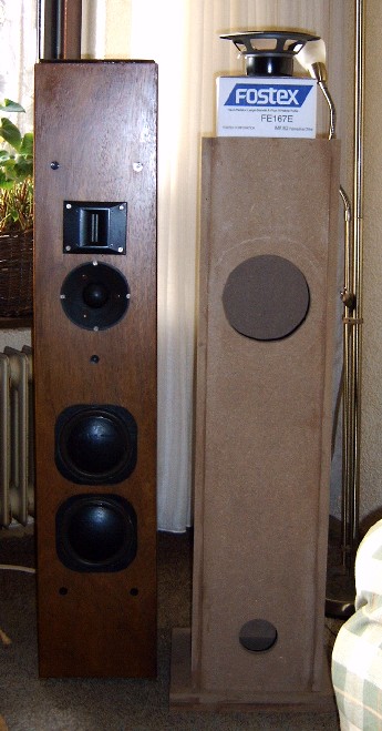

They are burning in .. about 30 hours
They sound outstanding very very good
And they need a bsc
imaging is surprisingly good with reasonable depth
the coherence this speakers have is very good
everything seems to hold together so well
they have speed and impact
