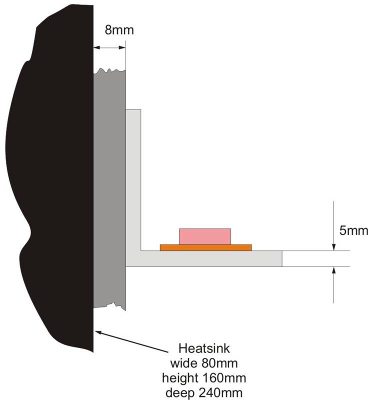

picture from the top of the heatsink..... the problem is bad airflow perhaps - because of the small heatsinks - they have their radiators in the wrong direction (the don't go from the side plate to left and right but they go along the side plate of the housing)..... Also, probably - i have that aditional 8mm alu- plate that represents aditional thermal resistance.... I will try to put small heatsins on the top of every mj15003 to aditionally cool them also.... maybe this would work to turn the temperature down.....
I would say that that plate you have sandwiched between th L shaped metal and the heatsink probably doesnt help.
The more gaps you have to bridge using heat sink compound the more thermal resistance you get, and if your transistors are much hotter than your heatsink then their is definatly a thermal resistance issue.
They should be of a much closer temperature if well mounted.

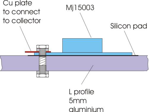

Here is how I have made it..... everything is o.k. and connected very good with silicon pads between the trans and the L profile
Just a SINGLE bolt? I really hope that you have been lazy in draving, not drilling 😉
BTW. Silicone pads are sub-optimal compared to mica&thermal grease.
For really badly machined surfaces I recommended something like Arctic silver, available from computer stores. heat conductivity is at least 10 times better than ordinary heat transfer compound. And so is price.
Big single cut file is good in straightening aluminium pieces, but you need some practice with that. Sanding rounds off edges too easily.
😀 lazy in draving, laaazy in drawing - sorry.... so if I am understand it right - You recomend using mica transparent pads and thermal grease - tell me that this will help a little bit --- jessus, I have asked the guy is he 100% sure that silicon is better---- he said yeeeeesss - of course - like I am an idiot or something..... 😡

sunrise said:I will try to explain.... My mj15003 are connected to the 5mm aluminium L profile. That profile is connected to the 8mm 330x150mm aluminium plate that hold 12 small heatsinks together as one heatsink. picture attached
Calculate the thermal drop along the 5mm plate.
The equation for thermal resistance Case to Sink is: (sorry, I'm using inches)
Units: K is watts/(inch times C)
For aluminum, this number is 5.3, for copper, it is 10.2.
Length is in inches
Area is in inches times inches..
For your setup, assume a 45 degree spread, one inch from die to sink, .2 inch plate thickness.
The 45 spread opens to 1 inch at the sink, the average is .5 inch width.
So, your calculation is based on a structure that is:
1 inch long, .2 inches thick, and half inch effective width..
So, the calculation is: Theta C-S = 1 inch / (.2 inch times .5 inch times 5.3 W/inch C.
theta C-S = 1/(.2 * .5 * 5.3) degrees C per watt
Theta C-S =1.88 degrees C per watt.
This is the difference between your heatsink mount to the TO case. If you are dissipating 10 watts in the zistor, you are almost 20 degrees above the heatsink..
Yes, it's a model, and is not as exacting as one would like, but it shows how effective the plate really is for heat extraction..
Cheers, John..

Use 2 bolts to secure the MJ15003. With only one, the transistor is lifted on the other end, so almost no contact with bracket.
Correctly mounted, you will get about 10 deg centigrade difference between MJ15003 case and bracket, assuming bracket is normal alloy extrusions meant for fittings and not heatsink alloy.
Waste of time, thermal resistance to top of to-3 is huge compared to even worst L-bracket, there is maybe 0.2mm wall thickess for 5-8mm distance. And TO3 packages are made of steel, invar or something similar lousy conductor(well, some of them are aluminum but I think aluminum cases are more thing from past.)sunrise said:
I would try to put some heatsinks on the mj15003. Maybe that will help...![]()
You should minimize distance from TO-3 case centerpoint to heatsink, as shown earlier in this thread thermal resistance of your L-bracket is quite high. Copper would be definetely better material but availlability at your local stores might be a problem.
