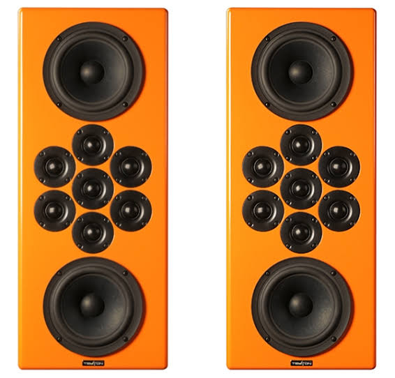

Hello, I want to know what the advantages and disadvantages to combine 2 silk dome tweeters and two titanium tweeters would be.

I want to make some changes to my sound and I have two silk dome tweeters for each speaker in my system. Then I'm thinking about adding more two, but made of titanium.
One tweeter per speaker box generally speaking. Also, if you’re not well understood about crossover and speaker design I would suggest leaving them as they are.

I'd say a disadvantage would be if both types played the same part of the audio spectrum simultaneously. Comb filtering as was mentioned, because it's physically impossible to lay one over the top of the other; they have to be side by side, above / below and that finite distance between; comb filtering.
Now if you cross from silk to titanium at some frequency, then the problem goes away. That would be a 3-way, with just different frequency points for the cross than an ordinary w-m-t 3 way. Perhaps you can gain some advantage over running either the silk or titanium set alone, that could sell.

Supplementing a larger fabric dome tweeter with a smaller diameter metal alloy dome is something Harbeth has done with some success, but its hard to predict vertical dispersion behavior based on the acoustical environment its being used in. They even run both tweeters wide open. Some people like a rear facing tweeter supplementing the front in or out of phase. I'm not a fan of this as it affects coherence of soundstage and imaging in a euphonic way. It just sounds unnatural to me with acoustic music and vocal soloists.
