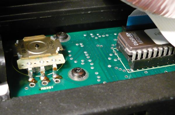

I was very interested by Chris's comment about Dremelling the chip out of the board, so took another look inside the Cyrus III at the HA7A Control Board.
http://j.imagehost.org/0436/cyrus_Ha7a_control_board.jpg
A websearch for ST 89340 returned nothing, but Z86E21F1 produces the goods, and tells me that this is a logic controller. Removing the transformer to gain access to the four T10 bolts on this board will probably be all that's needed but there's nothing that looks like a DIP package on the other side, based on the solder points visible from the inside of the unit.

the orig. AN's are from Zilog and on the device from your pic is from ST MicroelectronicsI was very interested by Chris's comment about Dremelling the chip out of the board, so took another look inside the Cyrus III at the HA7A Control Board.

http://www.zilog.com/docs/z8/appnotes/an0220.pdf
http://www.zilog.com/docs/appnotes/an0049.pdf
from
Zilog - Home
and datasheet also from Zilog
Z86E21 pdf, Z86E21 description, Z86E21 datasheets, Z86E21 view ::: ALLDATASHEET :::
in the attachement the photo of your URL, because such URLs sometimes short-lived
Hi sonokeling,
The volume control IC is on the main PCB, the selector IC is closest to the rear jacks. You can't miss it.

Also, don't touch the uP! You can't hope to make any good changes there! It always comes on with volume down, a safe way to start. The uP code can be changed if required by all service centers, and by the factory. Those sharp engineers at Cyrus will provide updated files when and if they become necessary. I said engineers because that is what Cyrus hires for product development, real live people who are well versed in analog circuit design and digital circuit design and programming. You should take a minute to respect the level of skill of the people you feel are not up to the level you feel they should be. I can also tell you that these are very nice people as well. I've met them and can vouch for the professional way the execute their duties. They also have better test equipment at their disposal than I do, and far better than most technicians will see in one place. The equipment must also pass a critical series of listening tests before a design is released to production.
