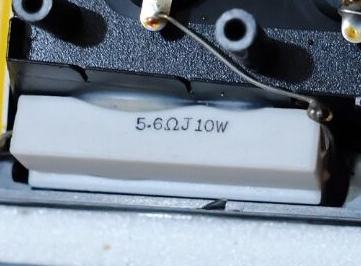

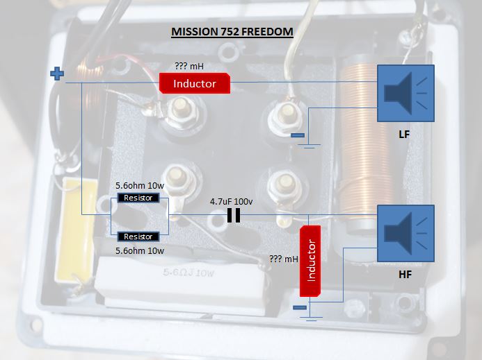

I'm new here but really seeking info for mission 752 freedom schematic.
Planning to replacing crossover part with better performance part.
What i can do right now maybe try to replace the 4.7uf cap with Sonicap.
Did anyone have the whole schematic for this speaker? google around nothing showed up.
kindly please advice.. thanks in advance guys
