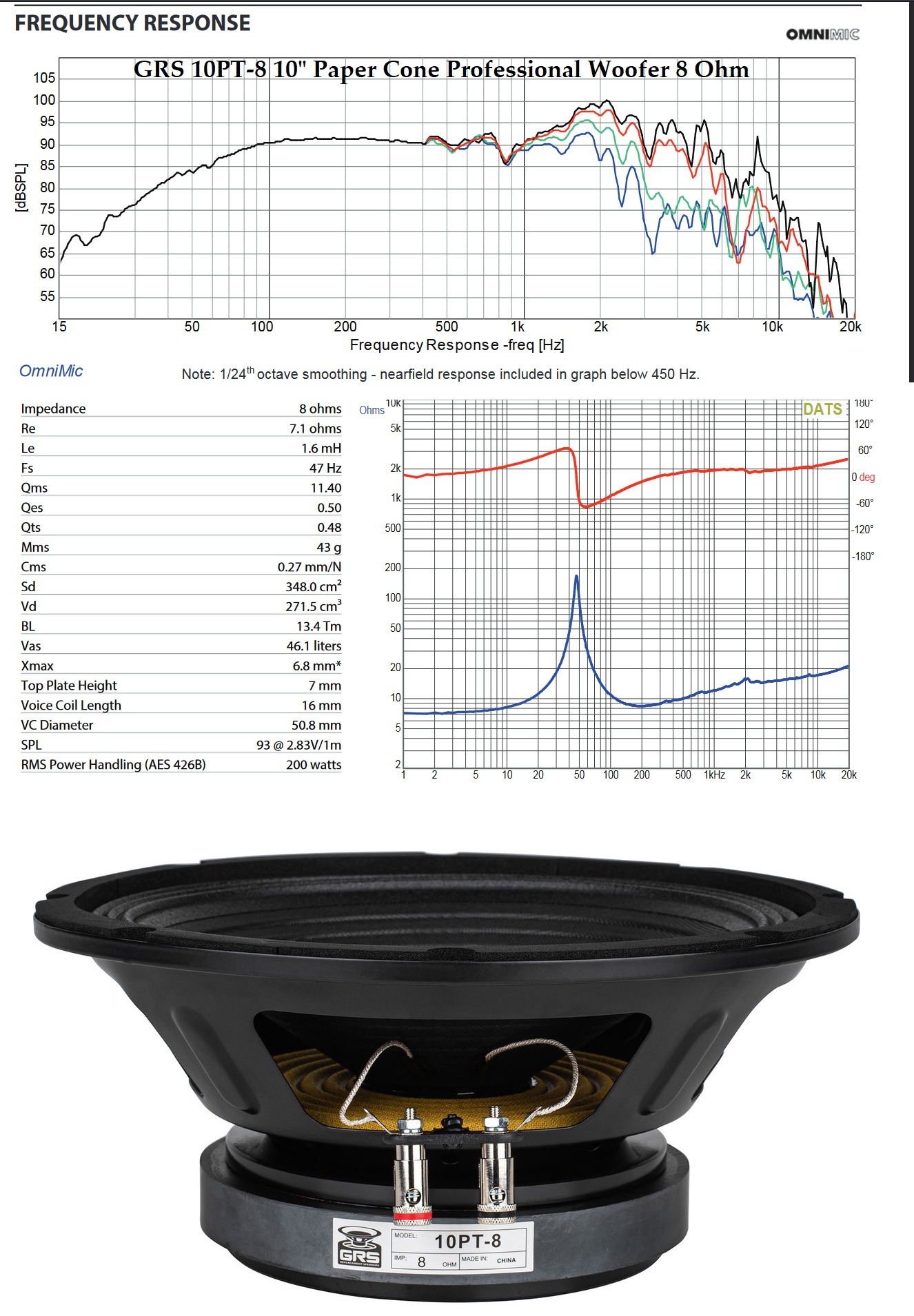

on the cheap US$ "PA-style" for a woofer - how much might it cost total up thar in Canada ?
https://www.parts-express.com/GRS-10PT-8-10-Paper-Cone-Prosound-Woofer-8-Ohm-292-804
The two main driver vendors up here don't seem to sell GRS, Amazon has a few, but not this one. Newark has lots of MCM drivers, very low prices, specs don't seem to hold up if looking at user experience, save for some specific drivers, probably 'newer' designs. Some are bound to offer great value though.

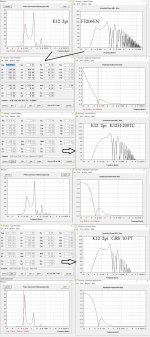

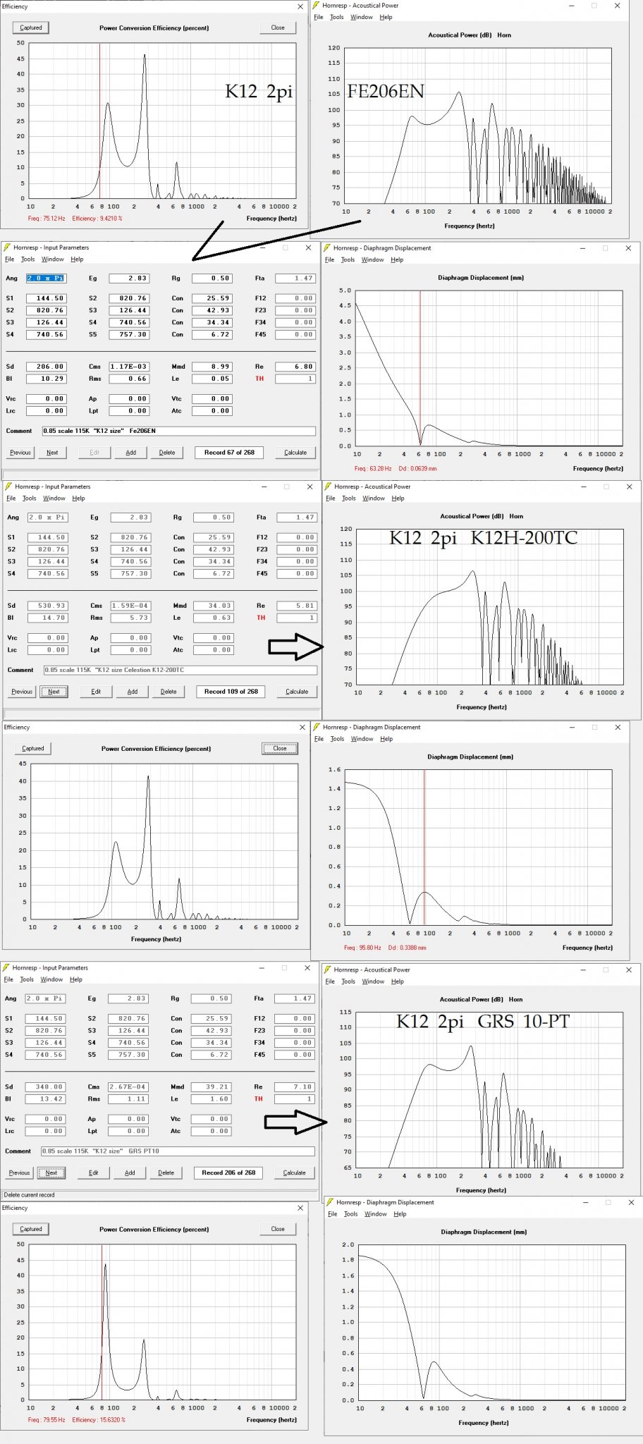

I picked up a couple of K12H-200TC cheap - hope someday to go back where my K12 are to try (house is in bad shape). The basket is nicer / stronger than TF1020 - very pretty design with mesh dustcap so the pole piece is visable--- can't load into the 12" XKi as the basket is a bit larger than that of Kappa 12A. Maybe with foam weatherstripping I could lay the cabinet on its back and let gravity hold the Celestion for some low spl evaluations.
That Celestion 12" FR should do nicely, perhaps even in any of the K12, Qt and Vas are fairly low.
