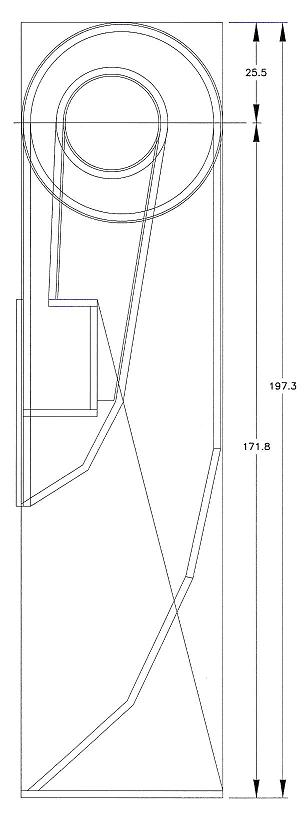

Stumbled across an old thread on the above. Wonder if anyone else has build it. In the drawing some
detail dimesions are missing. Would appreciate some feed back.

The Hedlund is pretty but the smooth curves mean too-much HF out the mouth. Mouth is also too small to go too low.
Dates from before we started seeing good design tools.
Too much work for what you get.

Well, all are entitled to their own opinion, but Hedlund Horns are designed as they are with an intetion to have a seemless transfer between bass and midrange, and they are tuned for excellent performance with Lowther DX2 or DX3 silver coils.The Hedlund is pretty but the smooth curves mean too-much HF out the mouth. Mouth is also too small to go too low.
dave
They where never intended to go lower than approx. 60-70 Hz since lower extension in bass will give compromises in the bass/midrange transfer linearity.
Hedlund Horns was designed with LMS as measuring tool. Still one of the best tools out there.
