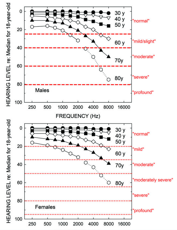

The equal loudness curves show what SPL in dB or phons is required for average early adult hearing persons to perceive levels at the same "loudness". At louder levels, the response of hearing tends to "flatten out".But first, what would be the apparent loudness level in from the above curves of 60 phons for me seated at 11 ft? How much lower than the sound of a small jazz combo at that distance? In any case, following the that 60 phon curve shows that 30Hz would have to be ~ 95db SPL to be as loud as 60 phons at ~ 1kHz, yes?
As age advances, high frequency hearing response typically drops considerably, the average 60 year old male hears 8kHz -30dB below an 18 year old, and 8dB less than a female 60year old. -10dB at 1kHz sounds about "half as loud", at low frequency the difference drops to half that.

Okay, but the curves you show say nothing about changes below 250Hz. So, assuming there is little reduction in hearing acuity with age below this, then at least nothing much above 95db would be needed years from now for me to perceive the same level at 30Hz.The equal loudness curves show what SPL in dB or phons is required for average early adult hearing persons to perceive levels at the same "loudness". At louder levels, the response of hearing tends to "flatten out".

Also, while it's true that "LIVE" small jazz combos can indeed hit levels > 110db + peaks at 11 ft, virtually all of my recordings-CDs and even higher res sources https://www.hdtracks.com/#/album/5df1427d0bee25c09bc163fd-were hit with substantial compression during the final mastering. The dynamic range of these and most recordings is far below that of live performances.
Therefore, "working backwards" from 95db @ 30Hz, what would the apparent loudness level of 1kHz in phons for a male 55 years at 11 ft? And in db SPL? Don't forget that it would have to way less than 95db, because the ear's sensitivity drops quite rapidly below ~ 200Hz. Am I making sense here?

As the Wikipedea article explained, the phon is matched to a reference frequency of 1 kHz.Therefore, "working backwards" from 95db @ 30Hz, what would the apparent loudness level of 1kHz in phons for a male 55 years at 11 ft? And in db SPL? Don't forget that it would have to way less than 95db, because the ear's sensitivity drops quite rapidly below ~ 200Hz. Am I making sense here?
95dB SPL @1kHz=95phon.
95dB SPL @ 35 Hz would sound equally loud as around 42 dB SPL at 1kHz, or the 42 phon level.
As far as reproduction of music, you may want to increase low frequency level when you play it back at levels lower than it was mastered at- what the "loudness" contour switch on many pre-amps or receivers does.
