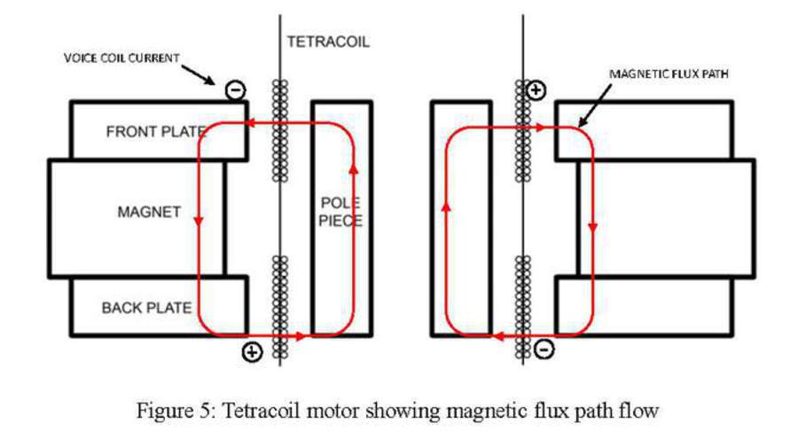

So would a dual voice coil setup also improve the accuracy of the lower midrange? Or is it just mainly for the bass region?
In most instances, NO (absent specific conditions).
One of the better uses is a "2.5" or "3.5" design where the ".5" (2nd coil) is compensating for some baffle-step loss (either passively or preferably actively). This literally improves the linearity in the baffle-step loss region (absent a baffle-step compensation filter, which necessarily reduces efficiency).
Here is something more exotic (and "sounds" a lot like the Energy Veritas solution) though I doubt that it substantively improves the passband of the lower midrange (depending on how you determine that pass-band):
https://www.eighteensound.it/en/technologies/aic-active-impedance-control/
(..as you go higher in freq. - yes, as you go lower in freq. - maybe. In both instances owing mostly to improvements with Inductance.
The dual-gap inversely wound voice coils is also how JBL did their version known as differential drive, IIRC. That is vastly different than the average DVC setup with a split coil in a single gap. One coil is behind its gap, and the other is in front of its gap. This means there is a constant number of turns within the gap of the driver, and keeps excursion linear and distortion low.

Dual gap /coils. Differential drive, the Eighteen sound Tetracoil is similar.
Uses they're ISV technology" too. Having coils wound on each side of the former for better cooling and stability. And double gap/ differential drive.
Found in they're NT series of drivers like 12NTLW3500 etc.
https://www.eighteensound.it/en/technologies/ttc-tetracoil-double-voice-coil/
