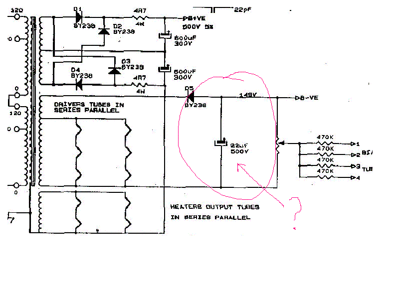

I found the -ve bias caps is leaking and i change it and the hum is gone ! But went i turn the volume to 9 o'clock the sound start distort / broken ! The polarity on the -ve is connected right or wrong ? I've check the voltage .. Bias -44V HT 450V ..please help. thank !
ps thank for ur advice. i'll take into account
here the power supply

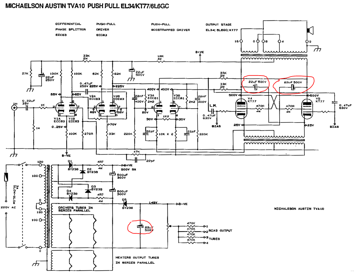

I also have acquired a TVA-10, but was not not lucky enough to have been given it, like the previous poster :)
I also have an issue with the electrolytic that is part of the power supply, ringed in the previous post. Why is that capacitor rated at 500V? Bias is set at 45V, and a 500V capacitor is a bit more specialised (and pricey) for replacement.
However, there are two more 22uF electrolytics, both 500V, used as part of the push-pull output stage, where B+ is set to 500V. That seems a bit marginal to me - any views?
Schema is attached. I would be grateful if someone could explain how the output stage is working. Is it just a separate transformer winding for GFB? Is this a common solution to cross-link the anodes and screens?

Yes, that 'lytic in the bias supply is well overdressed. A 200 Vdc rating is sufficient.
Yes, those 22 µF/500 V 'lytics are marginal. Better get 550 Vdc ones.
No, those multiple primaries in the OT's aren't for CFB. We see that unity coupled amplifier design, according to Gordon Gow's and Frank McIntosh's patents.

Well, the OTS' primaries are wound trifilarly. The lowest section at the bottom serves for NFB, the middle one as the cathode part and the upper one as the anode part of the load.
Those 22µF's can even be found in McIntosh designs, e.g. in the MC-3500/MI-350 (with a value of 10 µF here). Their positive leads might be swapped to the other ends of the 470R's, hence converting them to screen grid decoupling caps to ensure true pentode mode.

Hybrid connection that is half anode output and half cathode output?

YES - it was the TVA-1 that were exploding. It was designed by M&A themselves, whereas the TVA-10 is designed by Tim De Paravincini and did not explode.
Check out the schematic for E.A.R. 509... it is identical apart from the output tubes and the transformer ratios!

Found a TWA-10 in a dumpster, in the early 90ties IIRC. One of those "I can't believe my eyes" moments. There were 2 faults with it.
1. The mains switch were shot - easily fixed.
2. The second tube V2a/b is marked as ECC83 on the schematic. If you check the voltages noted in the schematic, on the anode of V1 (65V) and the cathode of V2 (70V), you see that this will not work with an ECC83. I don't know what the correct tube should be, but I used an ECC82 for V2 and the amp worked again.
