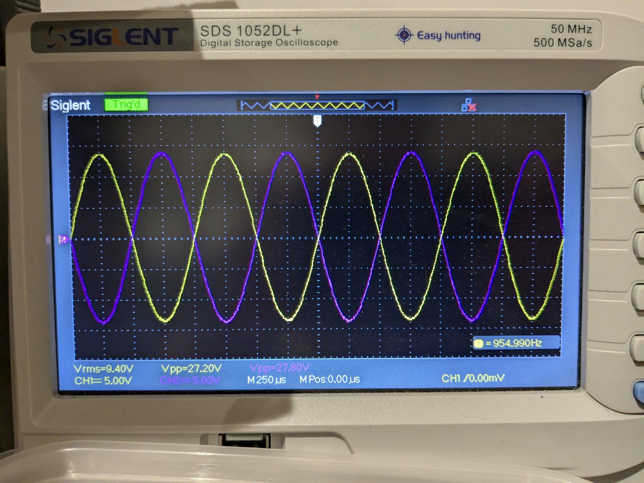

I've been testing the circuits and I've got some strange behaviour at the output. If I feed the preamp a 1kHz sine wave, I can balance the output to give equal amplitudes at both outputs, but when I increase the frequency, they go out of balance and the inverted output becomes larger than the non-inverted.
Here is the output at 1kHz

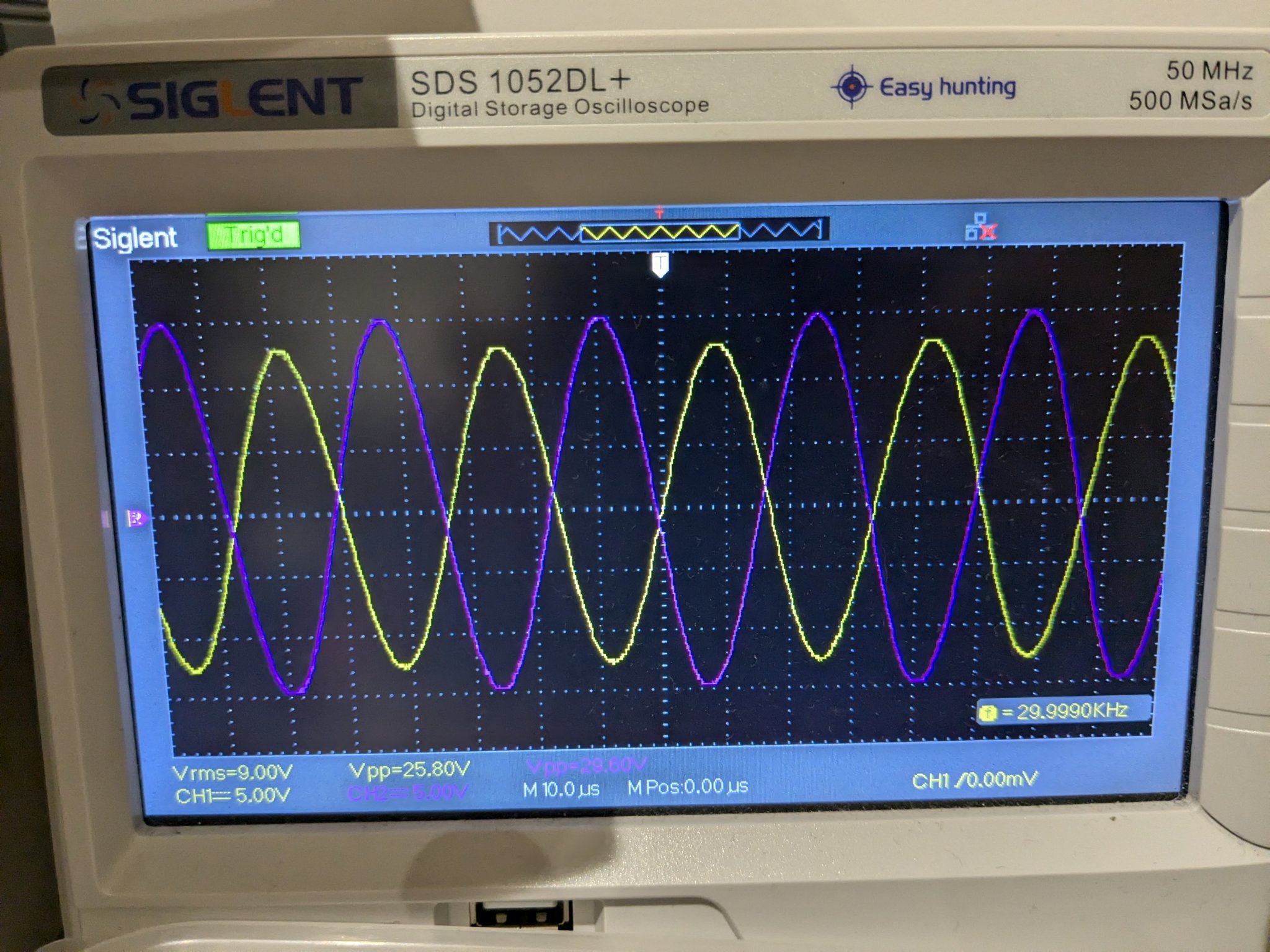

And at 30kHz
Any ideas what's going on?

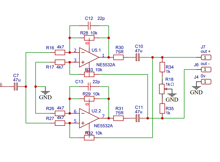

Here is the schematic for the output stage. The electrolytic at the input is shown as non-polarised but it is actually a polarised cap with the positive side on the right.
And at 30kHz

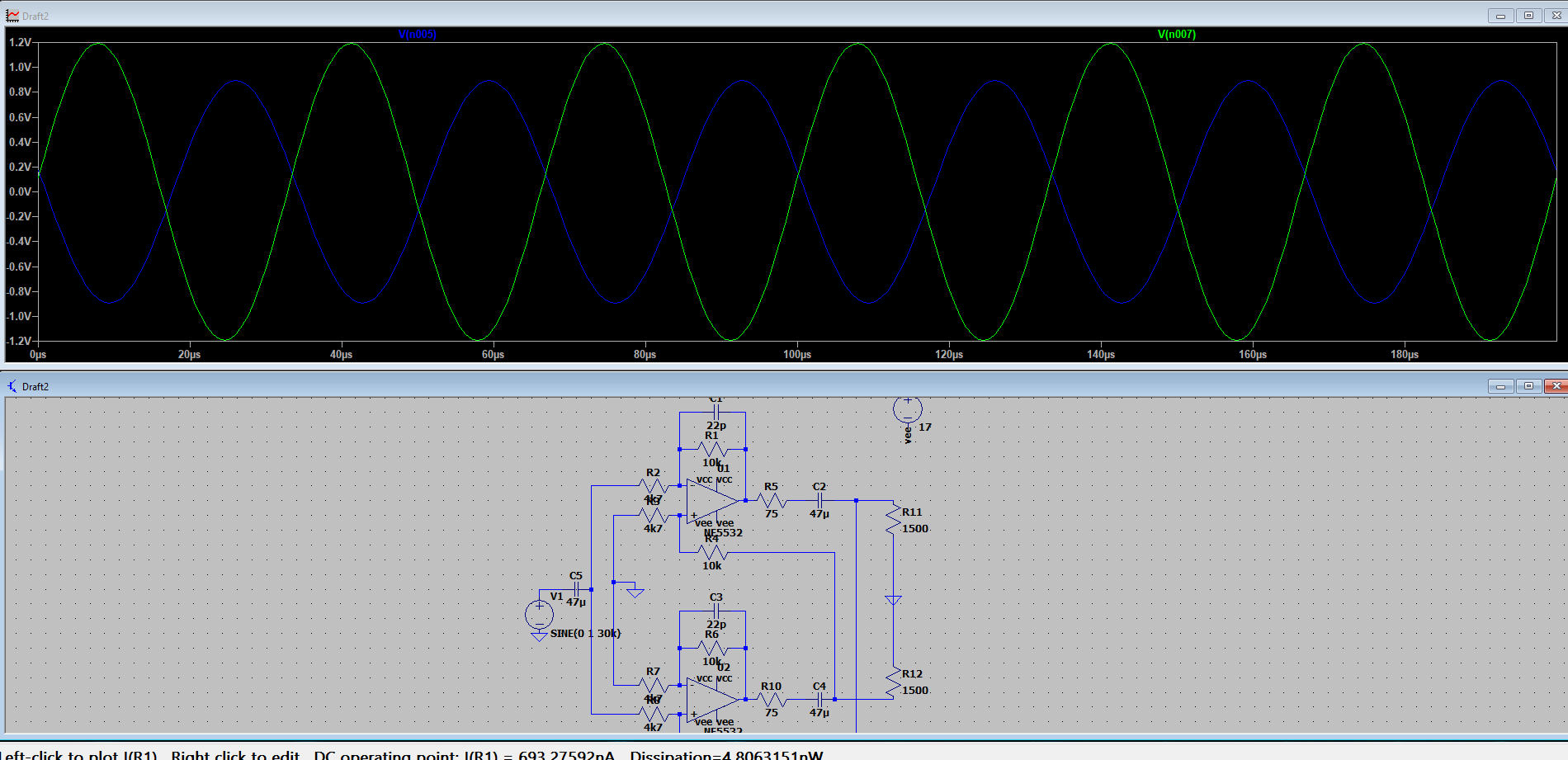

I've just simulated it in LTspice and I'm getting the same behaviour. it seems to be something I haven't understood with the circuit, rather than a problem with the build.
Thanks for the response. Could you explain why this leads to the observed behaviour, if you don't mind.
I realise that the bandwidth is different for non inverting and inverting configurations, but I didn't think that would affect anything in the audio range.
This seems to be quite a flaw of the circuit if the output doesn't remain balanced over the audio spectrum.
