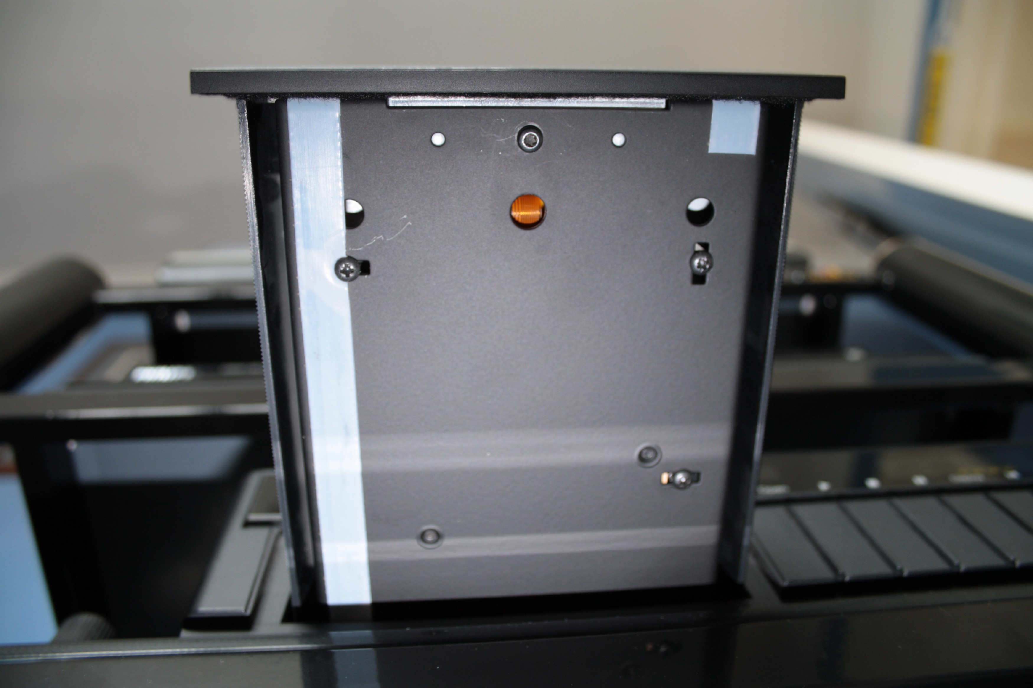

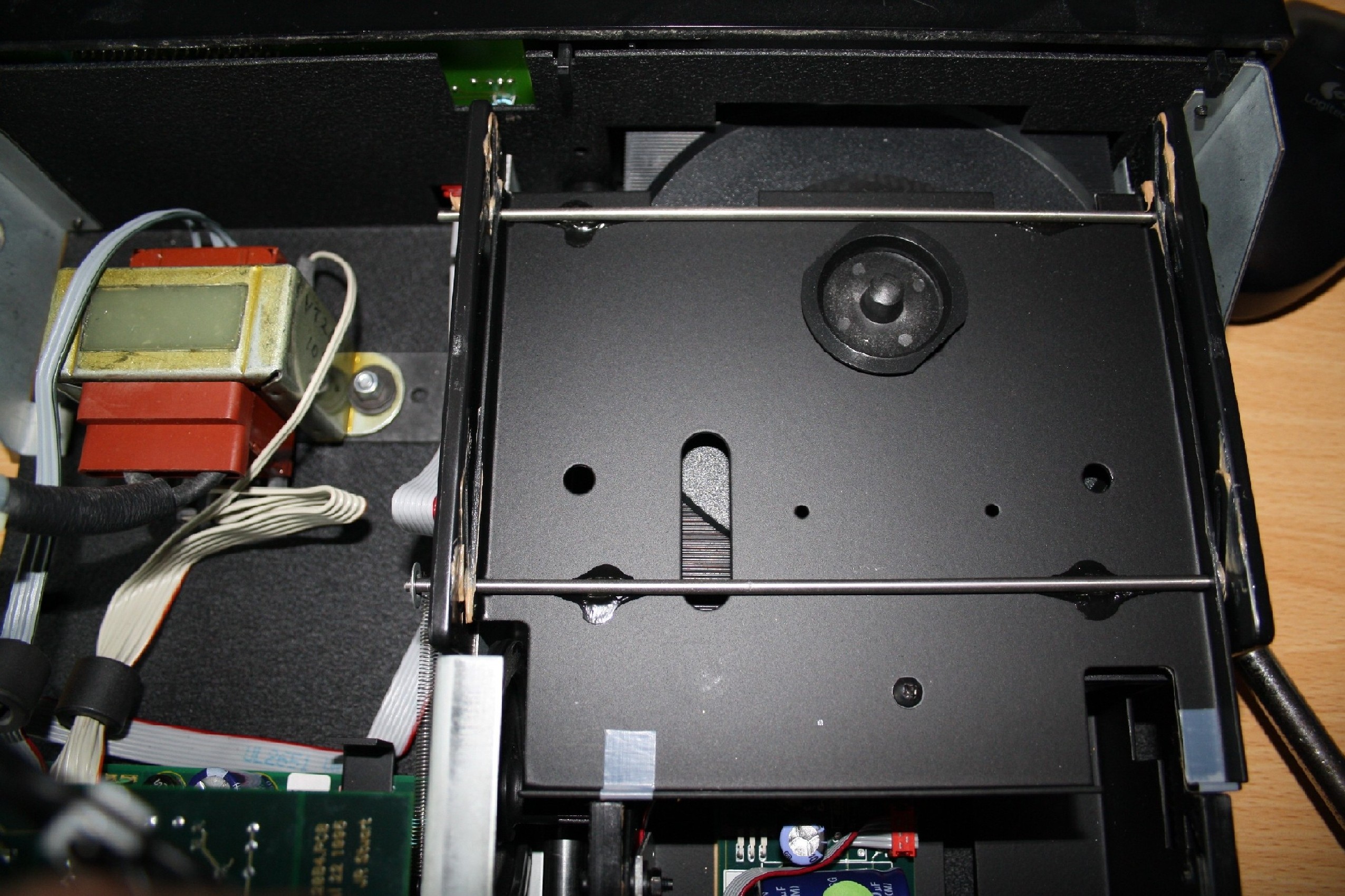

Pics attached. Firstly, just to clarify my earlier post. Meridian referred to the "bezel" as being the circular plastic mount on to which the centre spindle of the CD sits. It was explained that mine being solely black in colour indicates the transport being a CDM12.5 as opposed to the CDM12.4 which has a silver and black circular plastic mount
From reading, I understand that the CDM12.4 and CDM12.5 are not mutually compatible due to different motors and control electronics on board. I believe though that the laser blocks are compatible and that these can be sourced new as a separate unit, VAM1250
Anyway, back to the pics. The top shot of the drawer speaks for itself.
The second pic is the underside of the drawer, this being the only way in to the transport that I can see. There's no way that's immediately evident of removing the drawer
The third pic shows lid off with the loader/clamp exposed. The loader isn't like anything I've ever seen before and appears to be a Meridian OEM part
This was as far as I was willing to go with disassembly until I have a whole day to devote to it
** So to summarise, I need to know how to access the transport assembly for removal. Can you or anyone else assist **

Unusual for sure... in that the whole mech is incorporated in the drawer.
I'm sure it's easy to work on though. You will have to carefully remove the plate under the drawer and see what it looks like then. It could actually be easier to work on than the normal loader which usually has to be removed from the player.
Just take it slowly and take pictures so you know how it goes/run of any cables/ribbons etc.
The drawer-housed mech is the trick with some Meridian units. Apart from the 508 which I currently own, the 206 and 602 which I have since passed on both have similarly housed transports.
I agree - that bottom plate seems to be the key to getting to the transport. It's not going to be that easy to drop off though - what you can't see from the pic is one of the screws can't be accessed while the drawer is in place. So, the drawer definitely needs to come out.
Anybody else worked on a 5XX player with a CDM12 mech ? Anyone know how to get that drawer out ?

It could be either the CDM12.4 or the 12.5. The 12.5 were very common. My 500 Transport has the 12.5. The draw is tricky to get apart, first undo the single screw at the front of the draw, this releases the end of the draw. after this there are some more screws under there that release the plastic on the draw, remove this and the mech is bolted on to a steel plate. Can take a while to disassemble but it's pretty simple, there is no need to remove the casing of the player it's all in the draw.
