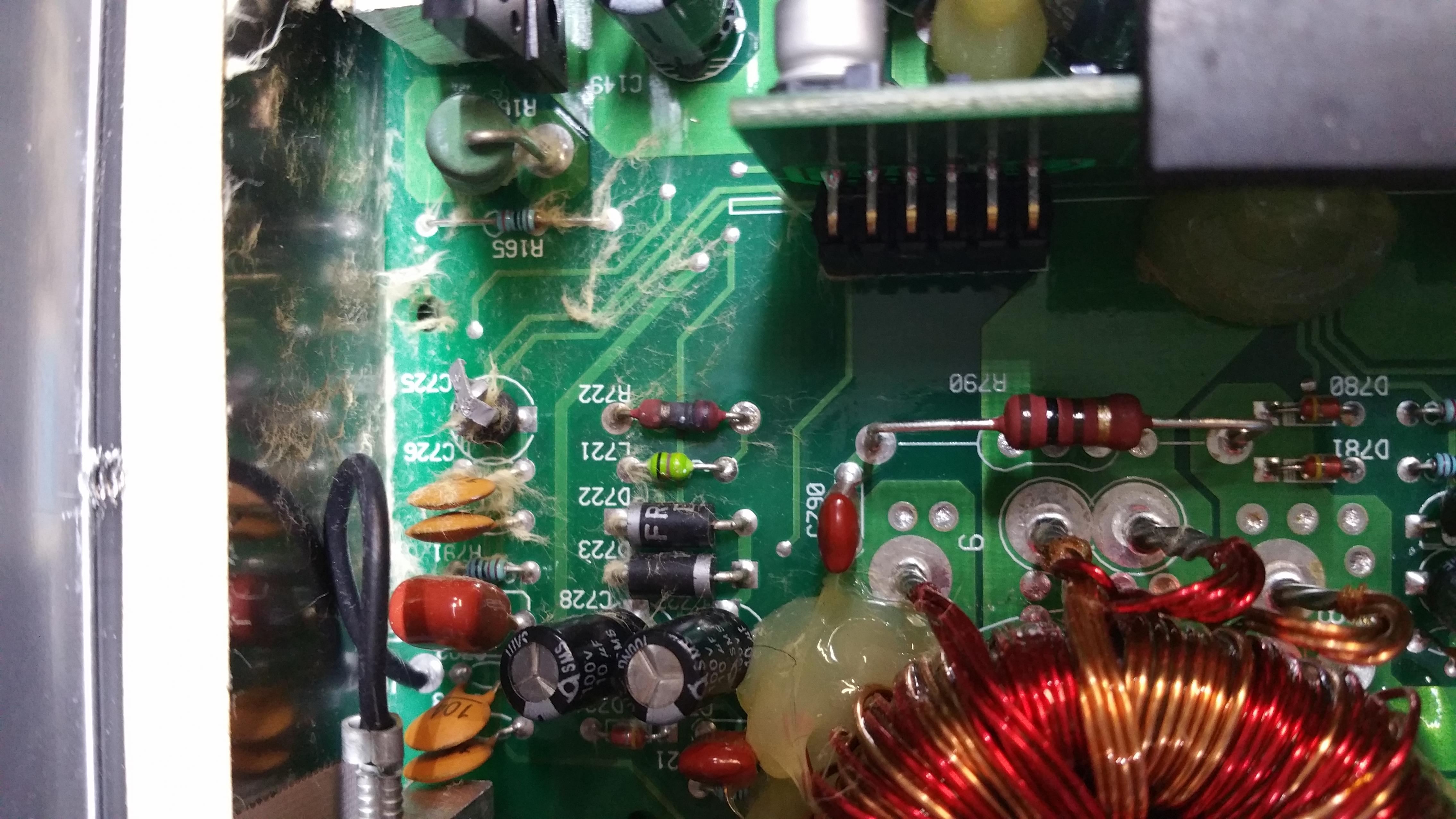

Hi I am looking for information on the value of a capacitor and resistance for a Memphis 16 MC150 ampilifier C275 and R722

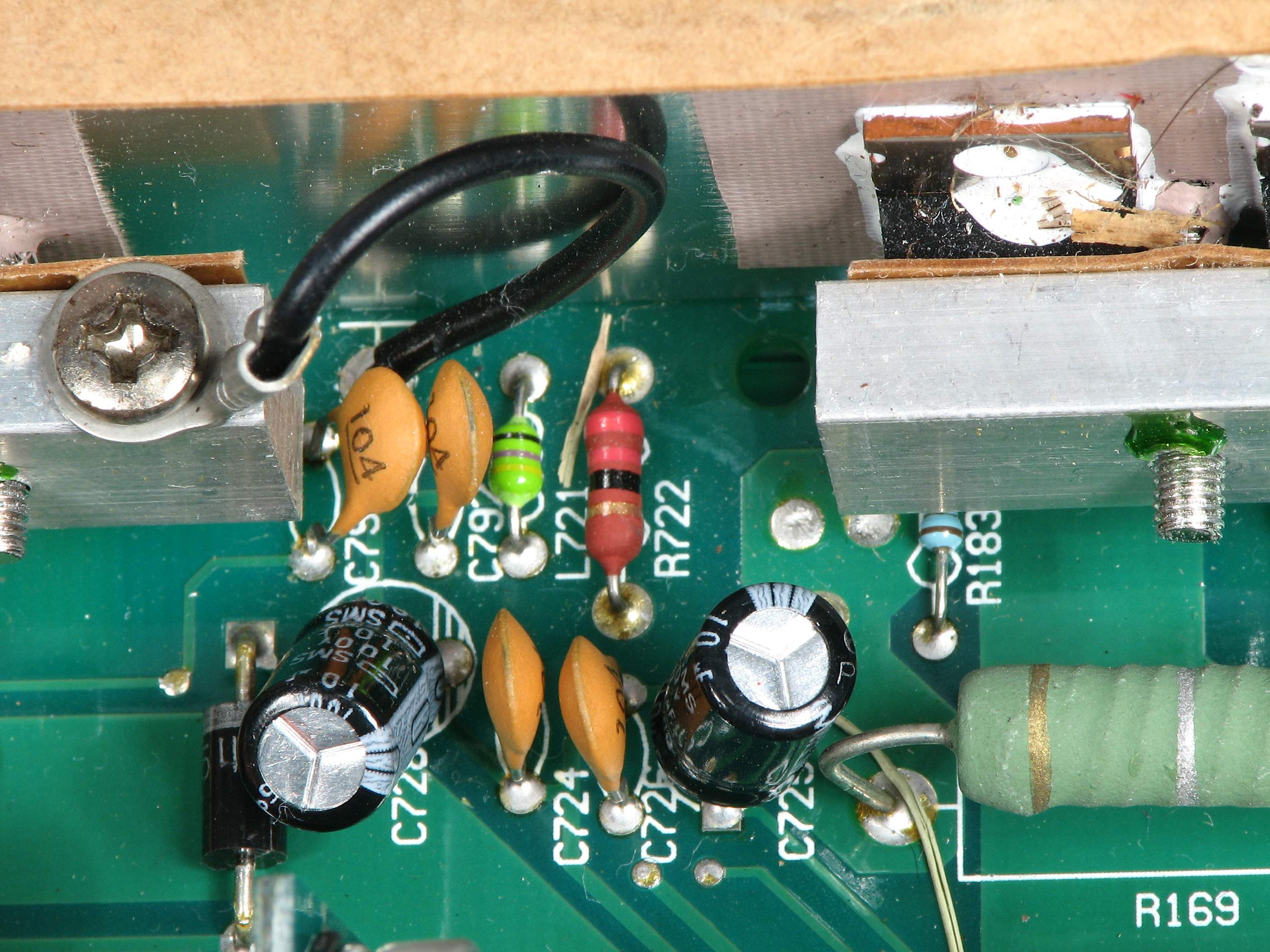

P Perry Babin Member Joined 2003 bcae1.com 2020-02-19 8:49 pm #2 2020-02-19 8:49 pm #2 Is this essentially the same? It's from a 300. The black electrolytics are 10uF @100. The resistor is 22 ohms. Attachments IMG_2301x.jpg 585.4 KB · Views: 43 joselorenzo Member Joined 2006 2020-02-19 9:00 pm #3 2020-02-19 9:00 pm #3 Thank you very much for your reply It is of great help to me You must log in or register to reply here.
