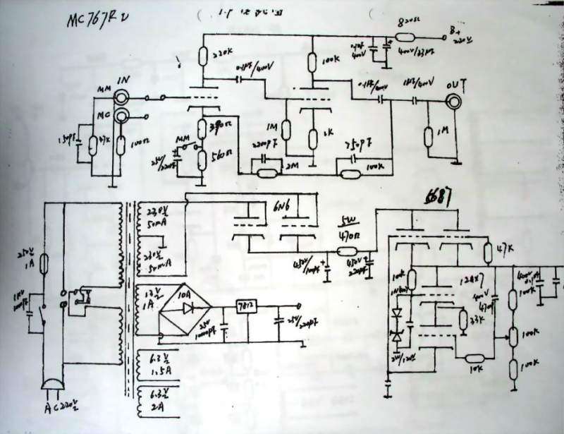

Here are the fotos of the meixing:
As one of the solutions some pointed me to connect a buffer stage..
Is this the best solution? Is there possible to change the meixing in order to low the output impedance?
I've tried to see what are the B+ Voltage, but I don't now where can I see it.. Or where should I connect my multimeter.

I have one of these - the old version, but it seems to be the same inside. I measured it to be 9dB down at 20Hz so it is very bass shy. I tried adding an output buffer, but to no avail - the 6N3 tubes (which was the compatible 5670WA in my amp) does not have enough amplification to make the RIAA network work correctly. Also, the older version has an error in the power supply, which I was able to track down (Meixing/Mingda sent me a schematic up on request) to some wrong wiring. I ended up keeping the corrected power supply and modifying the RIAA to a Hagerman "Cornet" inspired design (with 12AX7), for which I used the existing 5670WA tubes as output stage.

You have the new one. The old one is more wide than deep, while the new one is more deep than wide. Also, the old one had two switches on the front - one for on/off and one for MM/MC (the MC setting was totally useless!). Regarding the schematics, I'll try to upload them to my web-page later tonight. I'll have to get back with the suggestion for an output buffer - and as mentioned, it does not help at all with the bass problem.

I have made a quick web-page with the schematic and some photos at http://www.norre.dk/mc767rd/riaa.html.
At the first picture, you see my MC767 inside (there a few modifications to the RIAA section - this was while I was trying to make the original construction work). You can see it is very much like yours. In this picture I've highlighted B+ (and an alternative "almost B+" which is easier to access).
The second picture shows the modified MC767 with 3 tubes to the left instead of 2 tubes. You can see that your new version is simply turned 90 degrees compared to my older version.
The third picture shows the modified MC767 inside. The power supply has the modifications (I have written these on the schematic), a capacitor has been added and the RIAA is totally changed.
You can add a transistor buffer (or FET buffer) to the output. The problem is, where to get the voltage for the buffer. The easy point is highlighted in blue in picture 1 - there is a point with 18V. This point has two disadvantages: It is unstabilized and the voltage is too small! One of the advantages of a valve RIAA is the high voltage swing it is capable of. With 18V the voltage swing is realistically 6V-7V rms which is too low (I tried it and with a high output MM is could distort in loud passages). So I made the one shown on the page instead: It has 36V supply and 15-16V rms which did it in my case. This calls for a 36V power supply, which is displayed at the bottom of the page. Please note that R1=15kohm should be at least 10W (I used a 17W resistor) as the voltage drop is 264V and the currents in the schematic is when no signal is applied to the buffer. The 300V is taken from B+ and is actually a little lower.

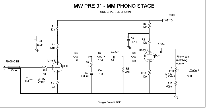

I found the same problem than Gorogoro (very low bass) and I will appreciate very much if you can share your experiences. In my country I have talked with a technical who told me that de RIAA in this amplifier is wrong, that is the same that you, Johnny, say.

I have changed the configuration, following the schematic, but the sound didn't improve
I am thinking that the best solution is to re-make again the amplifier circuit, keeping the same power supply...
Do you have any idea about what circuit I can use?
I rebuilt mine using the circuit from TNT-audio:
http://www.tnt-audio.com/clinica/ta/mwpre.html
