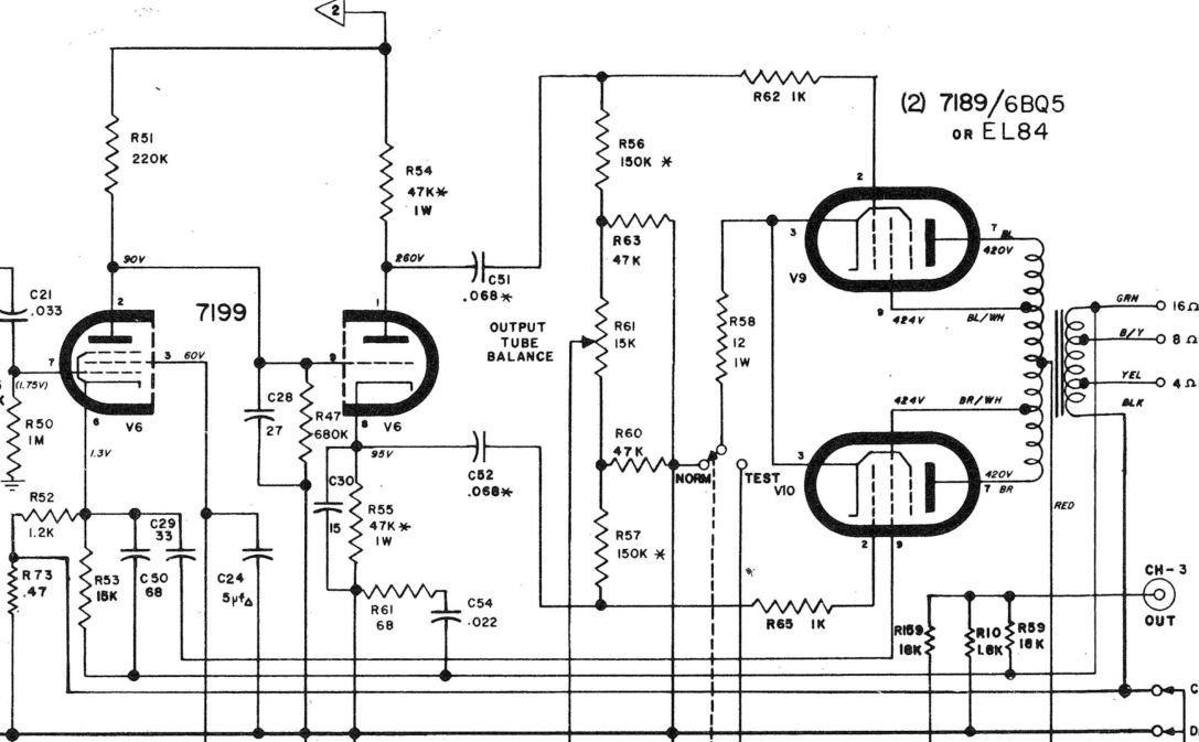

before building the 100W+ amplifier with 6P42S, I have decided to build a smaller amplifier for use with portable speakers for the times when I need to play something not at home.
I would need something around 25W of power output (and preferably make the amp not very big), so, here's what I have considered:
1. 6S33S SE - should give 15-20W, but requires a lot of power for the filaments and a lot of current (something like 450mA for stereo) for the plate, making me think about gas filled rectifiers again.
2. 6L6 PP - I have a lot of these tubes, the datasheet says that I should get about 26W in class AB1. The datasheet recommends 360V power supply with maximum current ~300mA for stereo, which is almost as bad as the 6S33S.
3. EL84 PP - I only have a couple of these and they are fairly expensive (8EUR), but smaller than 6L6 and the datasheet says I should get about 17W in pentode mode, with the power supply requirements are the lowest - 300V with max current of 220mA for stereo.
4. Something else? I would like to avoid tubes with top caps for this project.
A though about the first (6S3S and second (6L6) options - The 6S33S SE produces 15W for 200V*200mA=40W anode power dissipation (IIRC the power consumption of a SE amp does not change at full volume). However, 6L6 produces 25W and consumes 360V*93mA=33.5W at idle and 52W at full power. Shouldn't it be more efficient, being a pentode and operating in class AB? As it is, it pretty much consumes the same amount of power as 6S33S SE, except for the heaters.
Now, for the power supply part - for this project, I'd like to avoid tubes with top caps, which rules out damper diodes and gas rectifiers. I have a couple of 5C8S which are rated for 420mA DC and 1.2A peak (the datasheet does not specify whether this is for one or both plates together), though for the EL84 PP variant, a 5U4G would most likely be enough.
How much does the rectifier sag affect output? The datasheet for 6L6 says that the recommended circuit uses 93mA per channel at idle and 147mA per channel at max power. Simulating the power supply on PSUD2 with 900VCT transformer, 5C8S and choke input. results in 350V at idle and 331V on full power. Would that noticeably affect the output?
Using a cap input filter (with a 8uF cap) and a 700VCT transformer results in 360V at idle and 314V at full load, which is worse than with choke input.
Would the sag result in more distortion at high volume, or just less power than I thought?

You can get 20 WPC from the 6П14П-ЕВ (6p14p-ev), AKA EL84M, which is a genuine 7189 equivalent, by following Sherwood's S5000 "recipe". Any tube from the 6BL8/6U8/6GH8 group is a satisfactory replacement for the "extinct" 7199.
Stop fretting over B+ rail sag. Use high PIV Schottky diodes in the rectifier role. The Schottky diodes are every bit as quiet as vacuum rectifiers.
"Soften" B+ rise by inserting a CL-90 inrush current limiting thermistor between the Schottkys and the PSU filter.

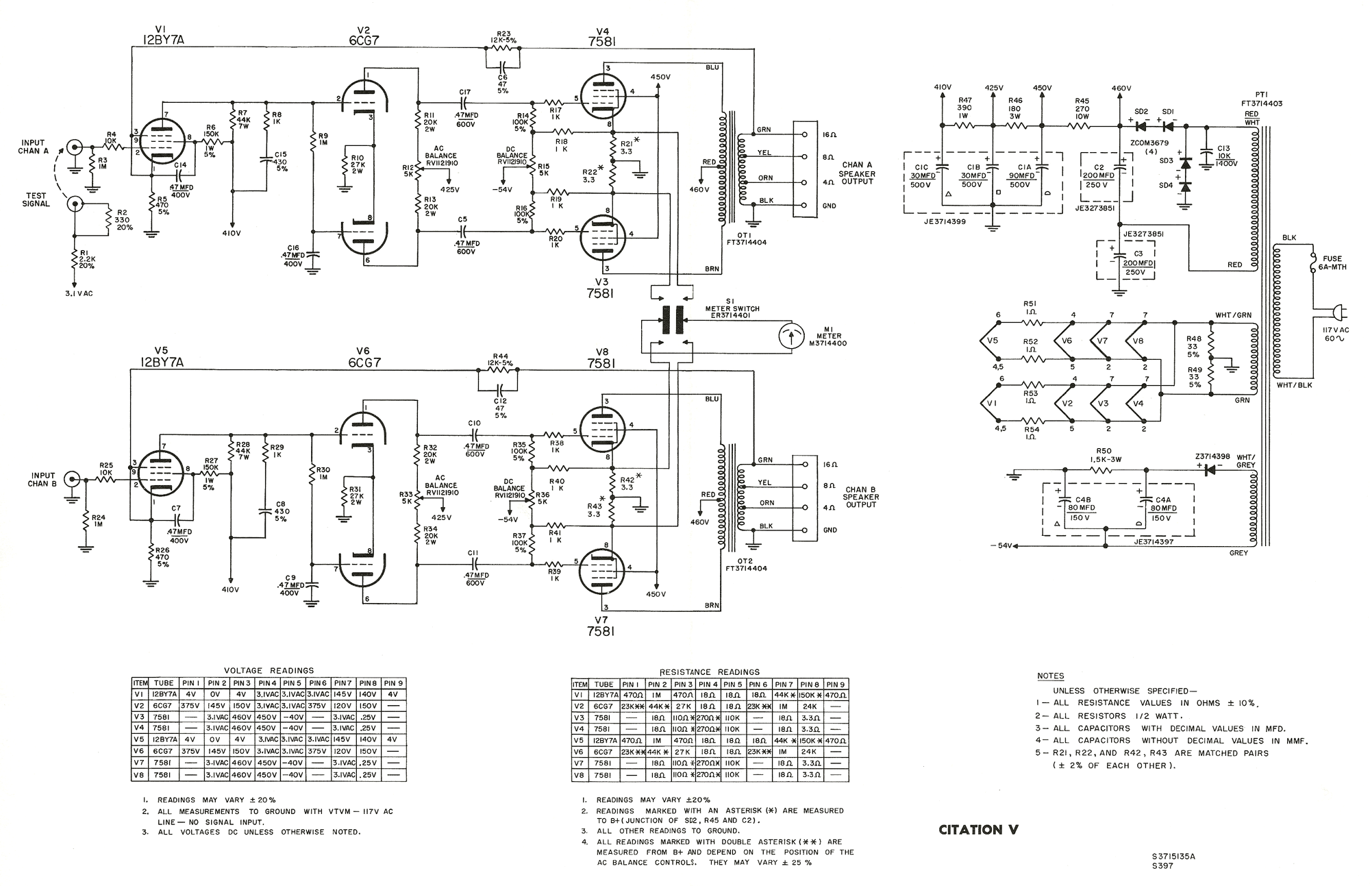

Could recommend me a circuit with two 6L6s in push-pull that is better than the recommendation in the datasheet?

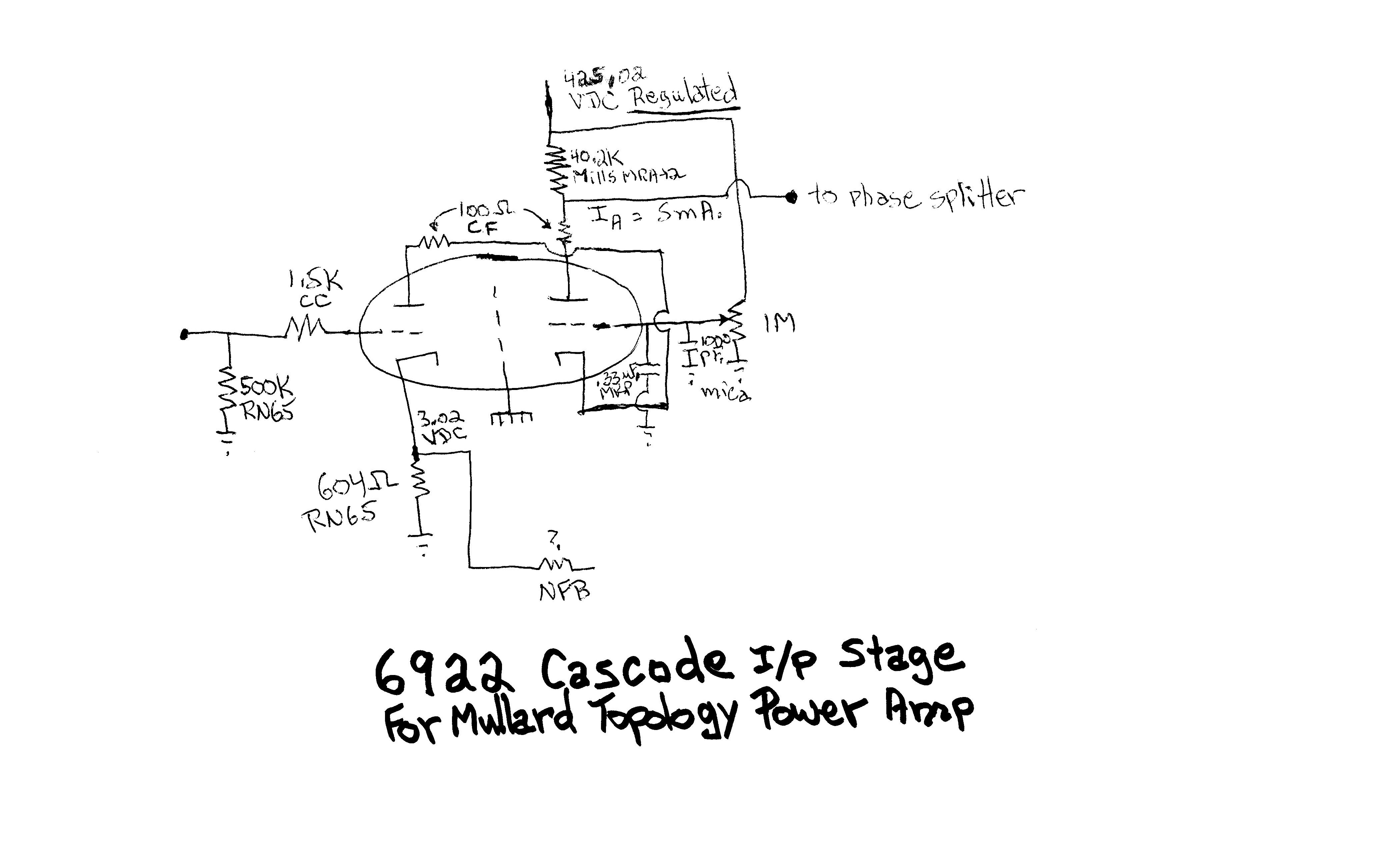

Sure! The H/K Cit. 5 is a superior implementation of Mullard style circuitry. Any 6L6GC "equivalent", including the 6П3С-Е, should be fine as the "finals". The 12BY7 is becoming scarce; so, I've provided a 6922 (6H23П-ЕB) cascode to take its place.
This "bad boy" will easily make 40+ WPC. Definitely use damper diodes, if you vacuum rectify the B+. The SS doubler shown leads to superior bass performance.
You need decent O/P "iron", for a Cit. 5 "clone". Edcor's CSPP100-MS-6.6K is suitable. Magnetic headroom is essential, when a GNFB loop, as is the case in the Cit. 5, is present. The headroom is needed to prevent the core from saturating, due to the deep bass error correction signal.
