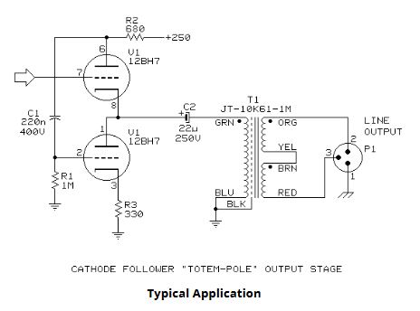

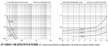

Works good at 20Hz @ 100mW referred to 600 Ohms (+20dBu), but only if driven from a 50 Ohm source.
What tube plate will be used that has an rp of 50 Ohms?
Lots and lots of negative feedback will lower the effective rp to 50 Ohms.
Is that a good way to use the transformer?
Great!
Not the best of ideas to drive a high impedance device to 50 ohms indeed. Jensen uses a cascode with 12BH7 so 4:1 would give reasonable amplification. Still, there's that large coupling capacitor so what is the advantage besides going balanced?
I played with the idea to replace the output cap with a real OT in my circuit to get rid of it. But, I wonder to what advantage as output impedance is already low and double numbers damping factor won't be that beneficial to drive a 10K solid state amp.
