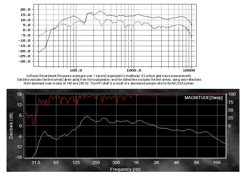

It sounds very similar, perhaps a little more controlled bass for the volume separation of drivers, for me is difficultd to be objectiv
I´m a little surprised for the high response measurements because the filter is the original, perhaps the difference is thath the published measurements is in a semireverberant ambient and my measurements are in a quasi anechoic room

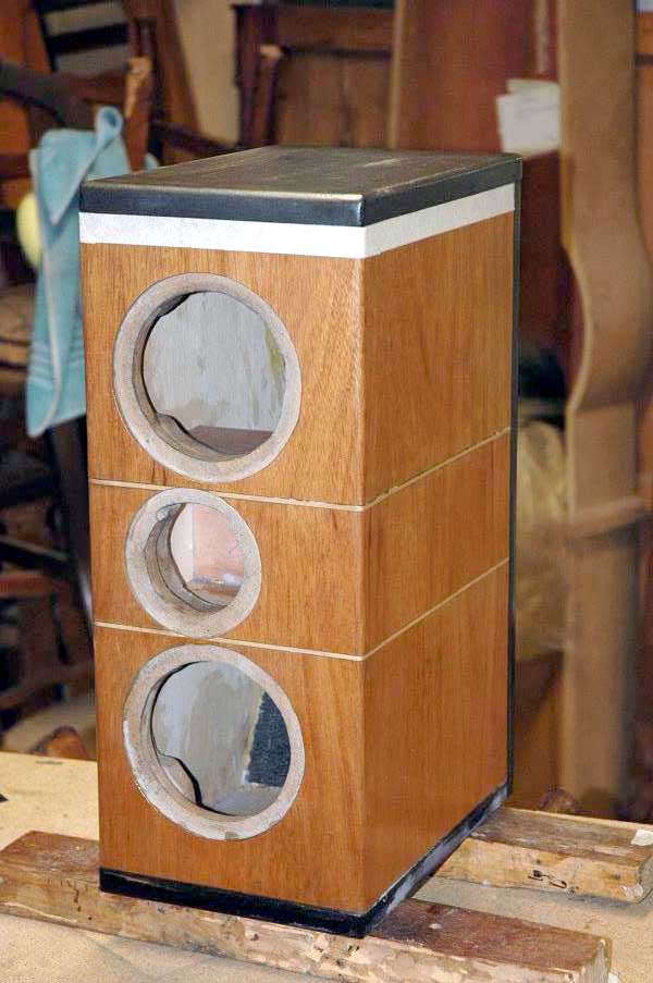

This the final result
