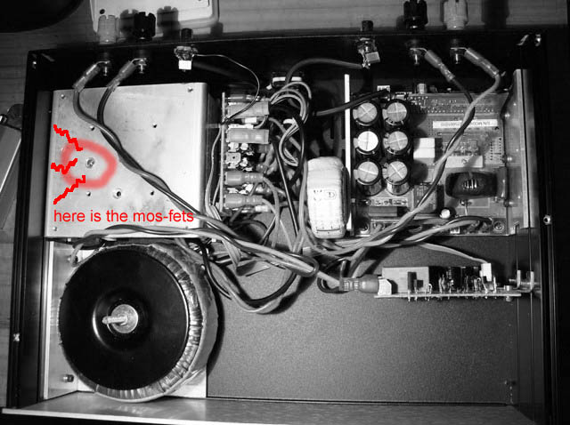

mods
LM4562 as input IC now
shortcut on coupling cap. offset now 30mv on both channels, was 5.
output relais on MCD pcb shortcut, using a speaker protection pcb now. Is more sensitive and looks at more variations on the speaker lines, either neg. or pos.

good job Bgt
you find an special way to install the modules
you attention that the place of the mosfet.
but the heat sink of mcd-255 is just 3mm ,
we Proposal that the best way is install to the bottom board as heat sink (if using the Aluminum bottom board )
but if your job will ok for home using ,
about the opamp, we used the dip transposon, so is very easy to replace the bb2134 with any OPs.
LM4562 is a very good op, 0.00003%

Bgt said:Fumac, the amp stays really cool. Should not be a problem.
BTW the "mosfet side" is closest to the amp. side pieces.
Sound is very..................very nice
Positioning of the modules is done for symmetry.
Crosstalk at 20khz is>100Db at full power/8Ohms/>80W/ch.
hi Bgt,
i'm so happy that you really like the sound from MCD-255
I do care about any modules out to the world,
all this modules is my babies.
i like them running at a good state, Healthy, and long life .
this time is winter, so the temperature is not hot.
but at summer , the temperature will rase up,
a high temperature of house will cause the more higher temperature of mosfet,
because the RDS(on) will higher when the temperature is higher,
and the RSD higher will cause more power loss into the mosfet....
this is a bad loop
so take care
about Crosstalk
if you use one transformer to one modules, Crosstalk will be best
