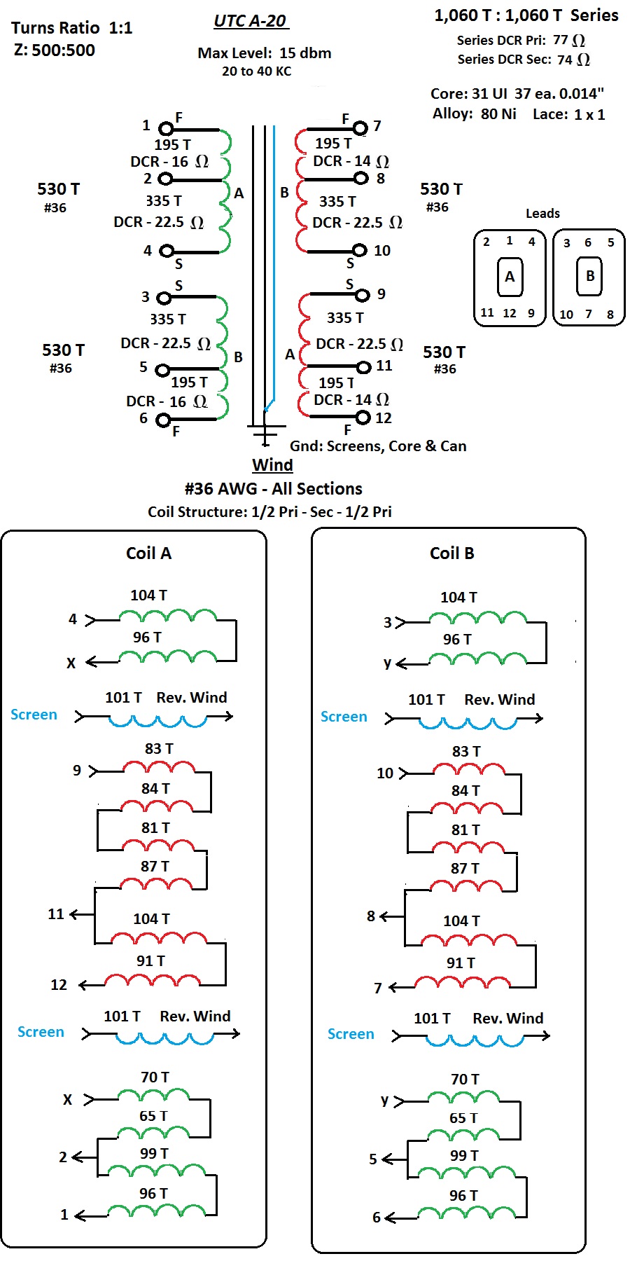

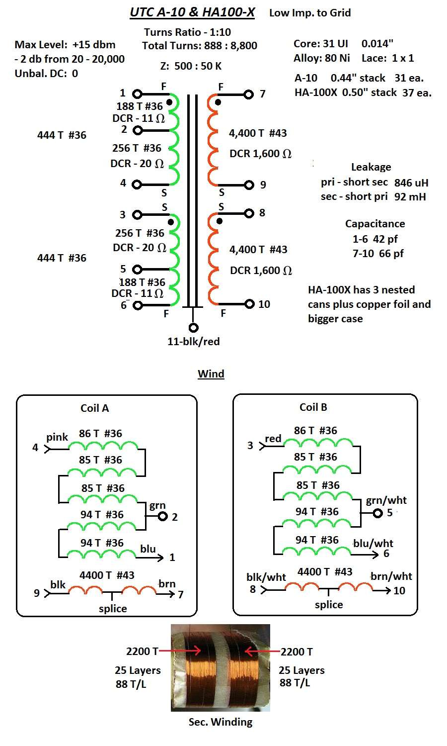

In the blueprint it states the secondary has 25 layers each winding so total 50 layers. But no mention of primary.
I think the drawing itself illustrates 6 layers per winding so total 12 layers, if I interpret the drawing correctly.
Posting both A20 & A10 side by side, just for reference side by side.
In the UTC A-20, a 600Ω:600Ω transformer, it also has 6 layers per winding so total 12 layers.
PS, Both blueprints are courtesy of CJ in groupdiy forum.
Have fun building!

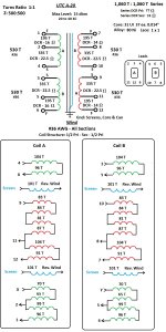

Have fun building!
