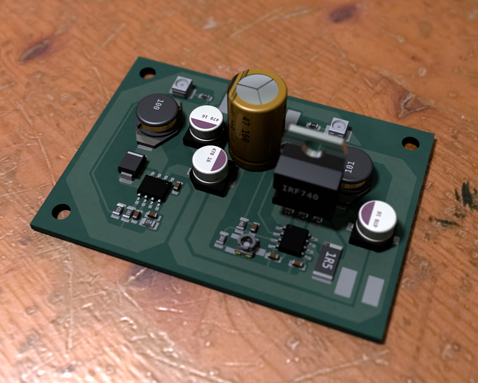

even this topic is rather "old", i just want to show my MAX9704-layout and prototype. PCB is done from FR4 35µm, single layer.
Circuit:
Fixed-Gain, spread-spectrum-mode, no standby.
Eagle:
TQFN-32 soldering on a Weller WQP 4000 SOPS
Prototype:
Under full-load i get ~42°C on the pcb's bottom-side. (at 22°C surrounding)
Cheers, Christian

It looks really good.
I'm doing a small circuit too using the max9709
I loved the 3D render , How did You do it ?
regards!!
regards!!

As for the 3d-rendering, this is done in eagle-3d with custom setup.

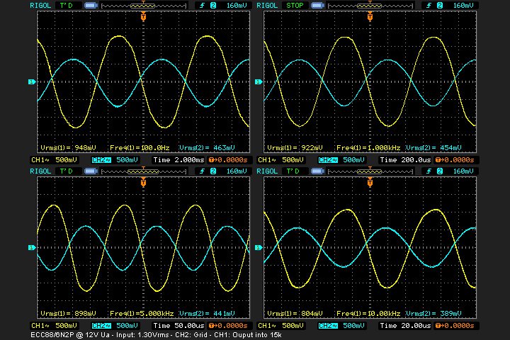

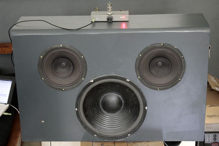

Actually im running a setup constisting a 9704 with a tube prestage (E88C) & 2 simple-switchers.
The 9704 is powered by 12V directy, the E88C is running at 100V anode-voltage (MAX1771 step-up) and 6.3V heater (MP1591 step-down). Everything housed in a small metal-case with no problems.
See the attached picture for the amp + the dual simple switcher pcb and frequency response of tube-buffer.
Cheers doc
