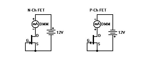

Test them with a 12v wall wart or power supply so voltage stays consistent, with a DVM in series. Let them heat up until the measurement stabilizes to somewhat simulate in circuit conditions. May take a minute or so but results are pretty accurate. They will change over this period and some more than others. What you measure initially and after they warm up can be significant. Consistent room temp is important too.

I have been using this simple test rig, Fig 9. All on breadboard, with connectors for fresh batteries and sockets for transistors. And two multimeters.
