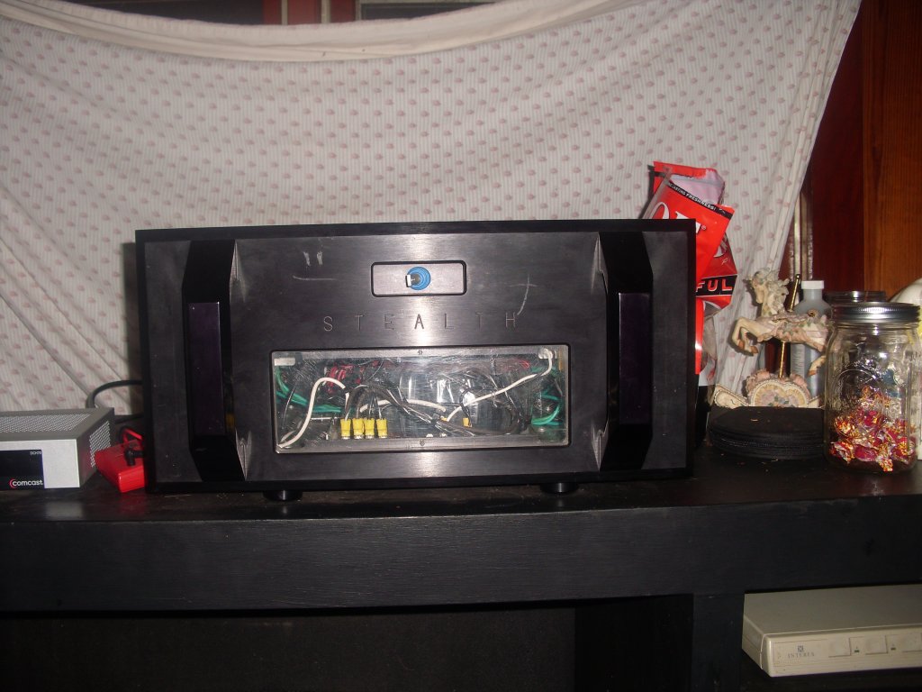

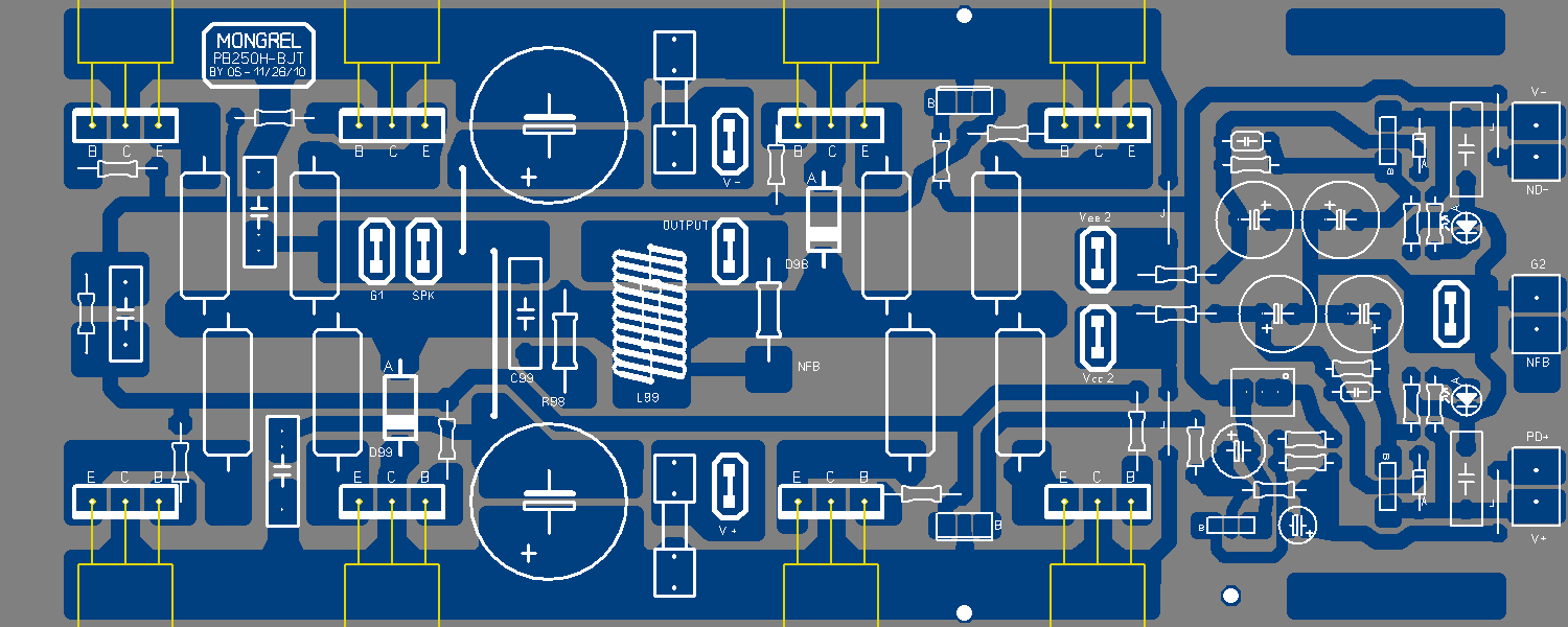

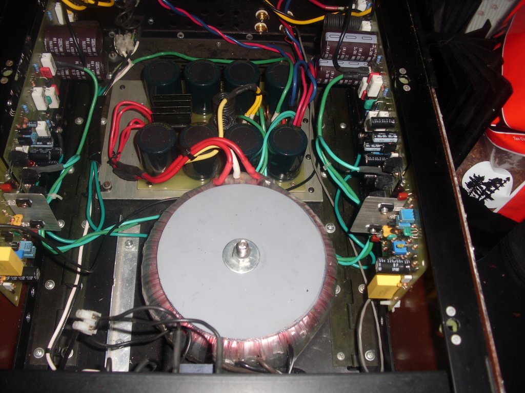

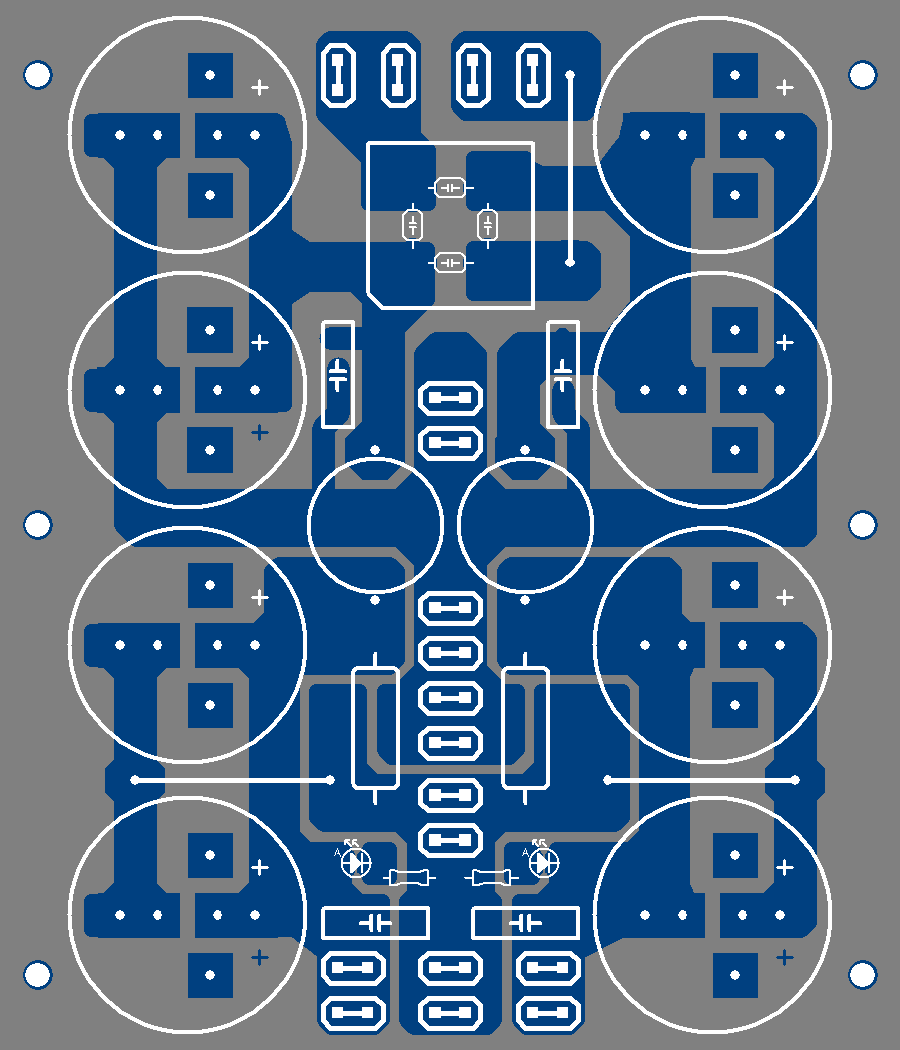

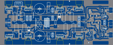

I am about to give my class AB 200w BJT creation a facelift (build a new PCB). It runs on 75 volt rails. I had the same circumstances as you , a old Genesis stealth case with monster 1KVA trafo / 80K uf power supply, extremely large heatsinks ,too.
I gutted it , bolted the trafo with the proper hardware and began to build. (Below 1 -2) fit easily into the classic case. I am now in the process of upgrading to the sprint layout pro board I just made and feel they would be wonderful suggestion for a large rotel (pictures ???) It is a shame , I might be throwing the boards pictured below in the amp out... to be replaced (by pix3-4).
