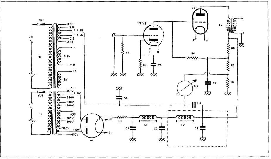

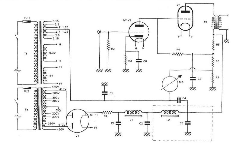

Power Supply Question
In the attached schematic, the mains transformer is tapped at 410V and going into the mercury rectifier. If I used a mains transformer with a lower voltage and reduced the value of R1 such that the voltage after the choke input filter was the same as it was at 410V, does that work? I assume, (and I need to do some more reading), that the values in the choke filter need to be altered as well.
Thank you in advance for any and all help,
Chris
Chris
Re: Power Supply Question
Dangerous. The 83 is designed to work with a choke input filter and i would imagine R1 is trying to look like a choke. Reduction may lead to fireworks.
chrismercurio said:reduced the value of R1
