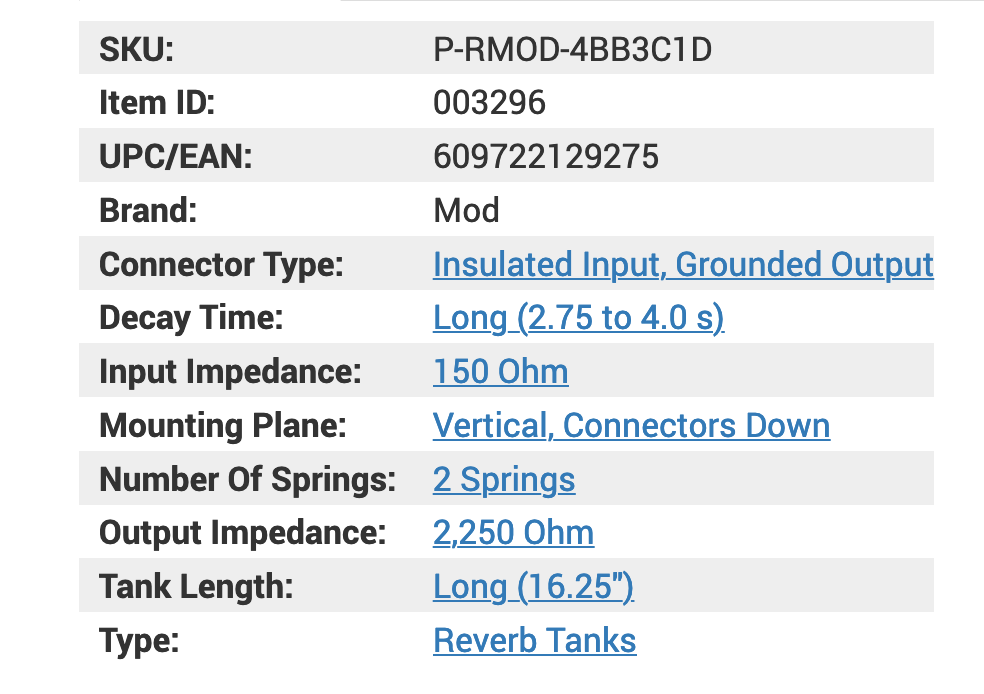

This Marshall JCM2000 DSL50 has a broken reverb tank. I want to get a new reverb tank. Does anyone knows the input and output impedance of the reverb tank suitable for this amp.
I have fixed reverb tanks before - pretty straightforward (sometimes involving micro-soldering)...have you made an attempt? They are cheap, but hey...
