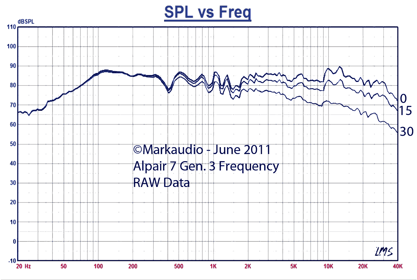

Mark audio never do off axis measurements which is just about standard fayre for wideband driver spec sheets.
Interesting, it doesn't answer the question as to why though. I was under the impression off axis measurements of wideband drivers was of particular importance? They mention it's a "wide dispersion" driver without showing what they mean. Usually, with wideband drivers, a rising off axis response is desirable as it gives a better power response.
The only ones who do it as far as i know are fostex and seas. And many brands of band limited speakers don't do it neighter. But i would also like to see more detailed specs, not only off axis measurements, but also DHT measurements of drivers.
But my experience with mark audio drivers is that their off axis response is rather good, there is not a big difference, and much less than Fostex, Tang band or Audio Nirvana have. I did not hear these altough, i only have experience with the Alpair 7.3, the Alpair 10.3, the Alpair 10P and the CHN110.
Never say never. They have published official off-axis, but annoyingly not recently.
