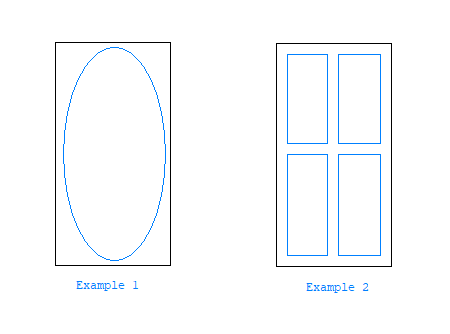

Hey guys

Second : I have an additional question about bracing.. I had an idea that 3 vertical braces should be installed (appx 40x40cm posts top to bottom, per language in the plans from mark audio. I’ve seen lots of photos and illustrations about “window bracing” and there doesn’t seem to be a consensus there. Can I use 40x40cm (diameter) top to bottom in 2 or 3 places? Anything that can help me visualize this would be much appreciated

More importantly, I hope you're on the road to recovery.
I don't really like window braces, but you have to be pragmatic about these sort of things -they're easier for many builders than longitudinal braces, and better than nothing at all, so when I did this creature series I used a doubled front & top baffle, which significantly improves the overall structural stability, and three unevenly spaced, relatively 'open' (to avoid disrupting the longitudinal standing wave) 178mm x 160mm x 18mm window-braces do the job 'well enough'. There's no fixed pattern, but avoid small holes & you need more or less 65% or > free space, so something like either of the attached would do. One other thing you can do is key the rear baffle into the doubled upper, rather than simply fixing it to the back.
