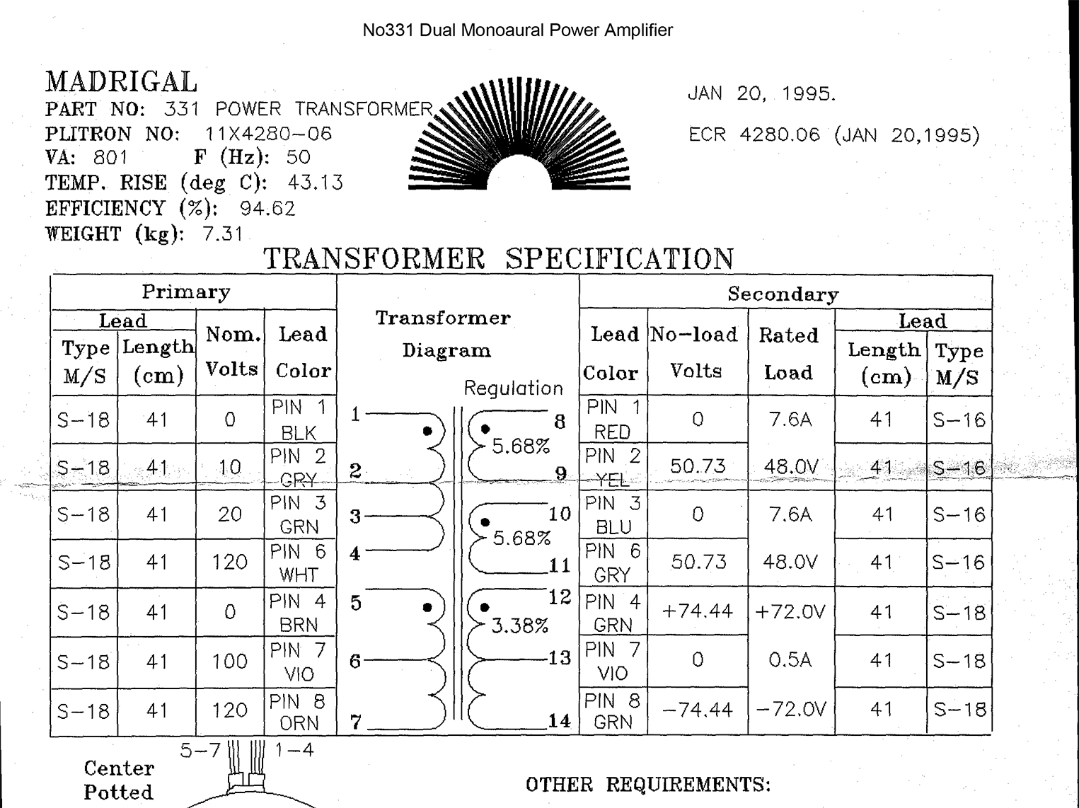

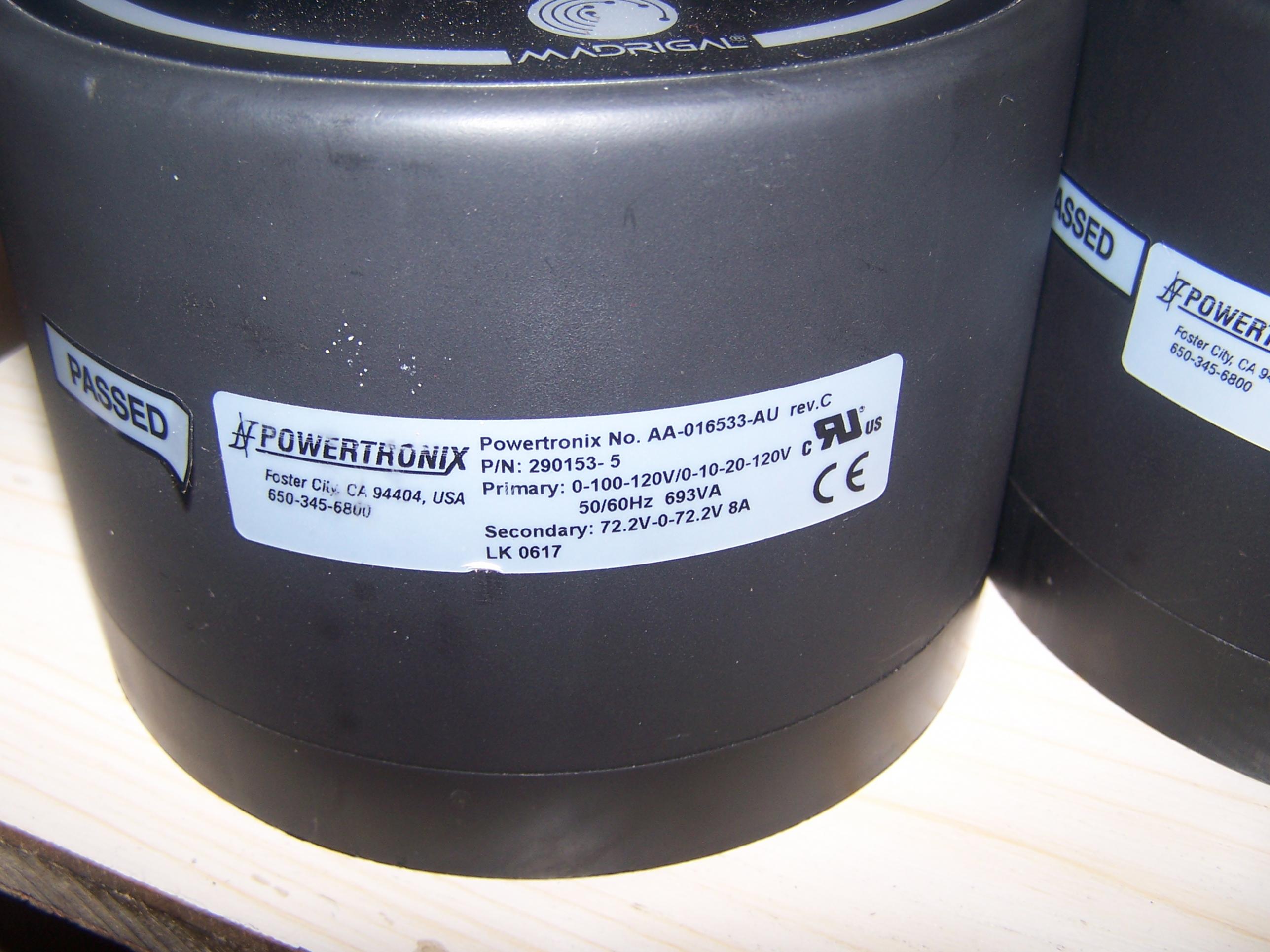

I know. Everything in this amp is a lot of work. 80v rail makes the use of the LT4320 borderline impossible.
Power supply rectifiers have to handle switch-on surges, so unless the amp has a soft-start circuit the size of the transformer and filter caps tend to determine what the diode ratings must be, not so much the load.
SiC diodes have a larger forward voltage drop which will lose you some supply voltage.
Tnx mark
You got a point
Yes the amp has a soft start
The transformer is 3.5KVA
There are 2 diode bridges
Each bridge charge 2x 68000uf filter caps
