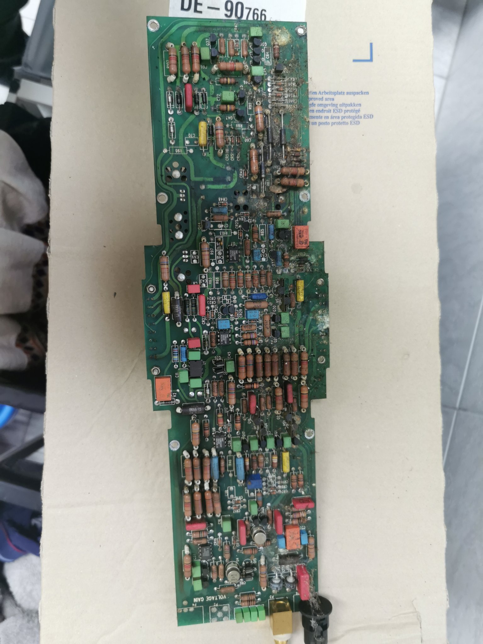

I have a broken Mark Levinson 333 that I want to repair for myself. It's working so far, but I have a problem on the Volage Gain board, which is why I can't figure it out at the moment.
The following were defective so far:
Q37,Q39 and the CR55 had passage.
After I replaced the parts, the Q36 gets around 100°C, but in the other functioning channel it only gets around 40°C
I had measured all the transistors so far and didn't find anything unusual. What could that be?

This is very wrong.
Collector should be ca. 104 Volt. With 50mA, dissipation should be below 260mW, but now it is way out at 1.45Watt, so be carefull not to fry it.
R79 should have slightly more than 1Volt, but is now only 0.5Volt.
What is the operating output voltage ?
I'll prepare some extra questions.
Hans.
Good news, that means that a lot of the amp is working and that your output stage is working perfectly.
Now, what are the voltages at:
Both sides of CR23/CR24, should be the same at both sides, ca.103Volt
The voltage over R64 and over R37, should be the same with ca 5 Volt
And from Q27, the base, emitter and collector, should be resp. 103.0, 103.6 and -45Volt.
Hans

i think I've found the problem. When testing the capacitors on the board, a via was apparently torn off.
But the condition of the board was already very bad. See image.
I'll test again this evening to see if it's any better.
Best regards
Mario
