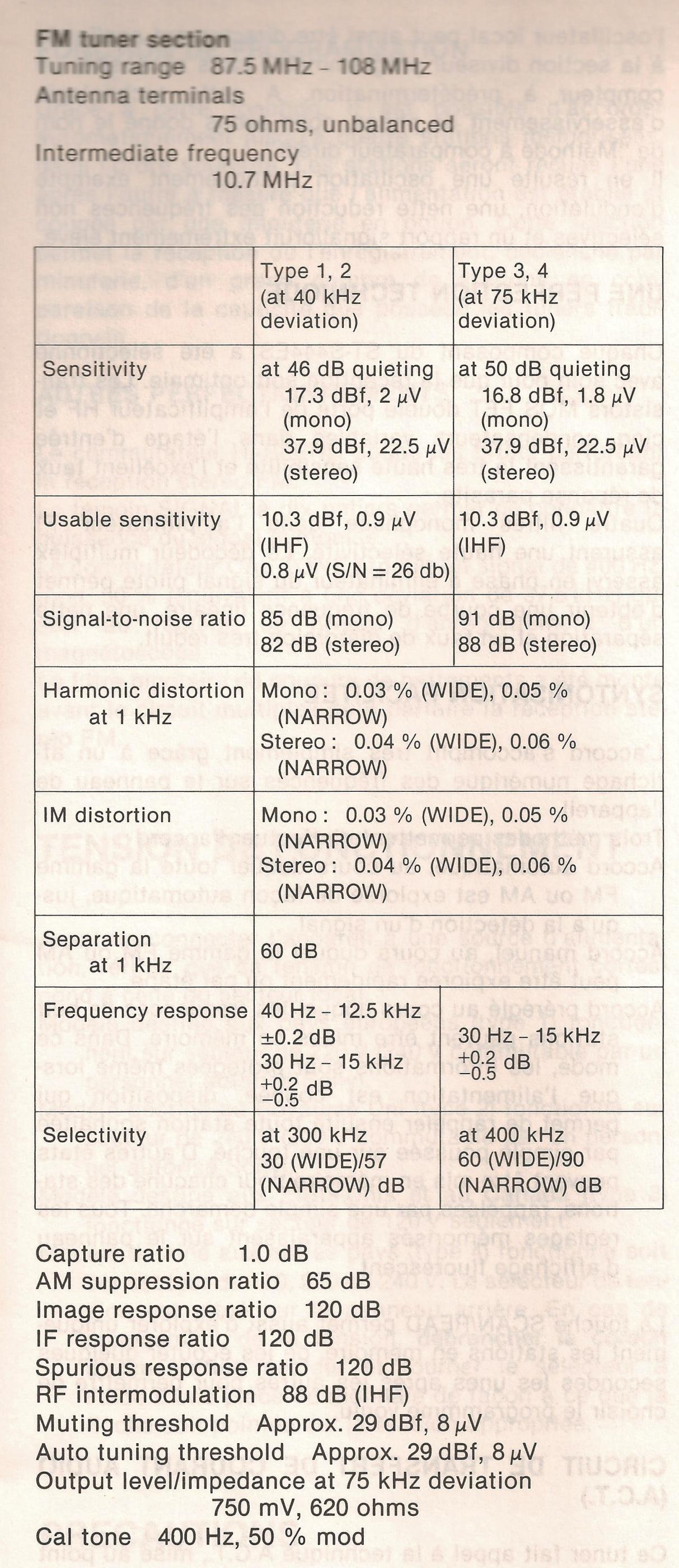

It takes big bucks to measure the specs on your datasheet. Sensitivity, selectivity, distortion, separation. I use the comparison test. If the radio in my car will pick up a station I like, and the new Sony portable won't, and the twenty year old radio I inherited from my father won't, I put e-caps in the inherited radio (which I did) which made it okay. The only household FM radio I've ever owned that would pick up weak stations and produce stereo, was the GE pocket radio from about 1990. The Dynakit FM3 wouldn't, but the alignment manual wasn't available free until last year. (thanks diyaudio). Most FM tuners take a lot more equipment to align properly than this kit. Distortion test, I listen to classical radio stations, and if the piano solo broadcasts don't sound like a Steinway, then something is wrong. Most FM radios produce the deadly hiss/dropout on weak station. I re-e-capped the Reader's Digest radio because my two favorite FM stations in this middleburg are kind of weak, and the $35 I spent at the store on a new radio was a waste of money. The Reader's Digest radio project worked, but the unit has to have been aligned right from the factory for re-e-capping to do any good. For real alignment procedures, see the links above in post 2.
