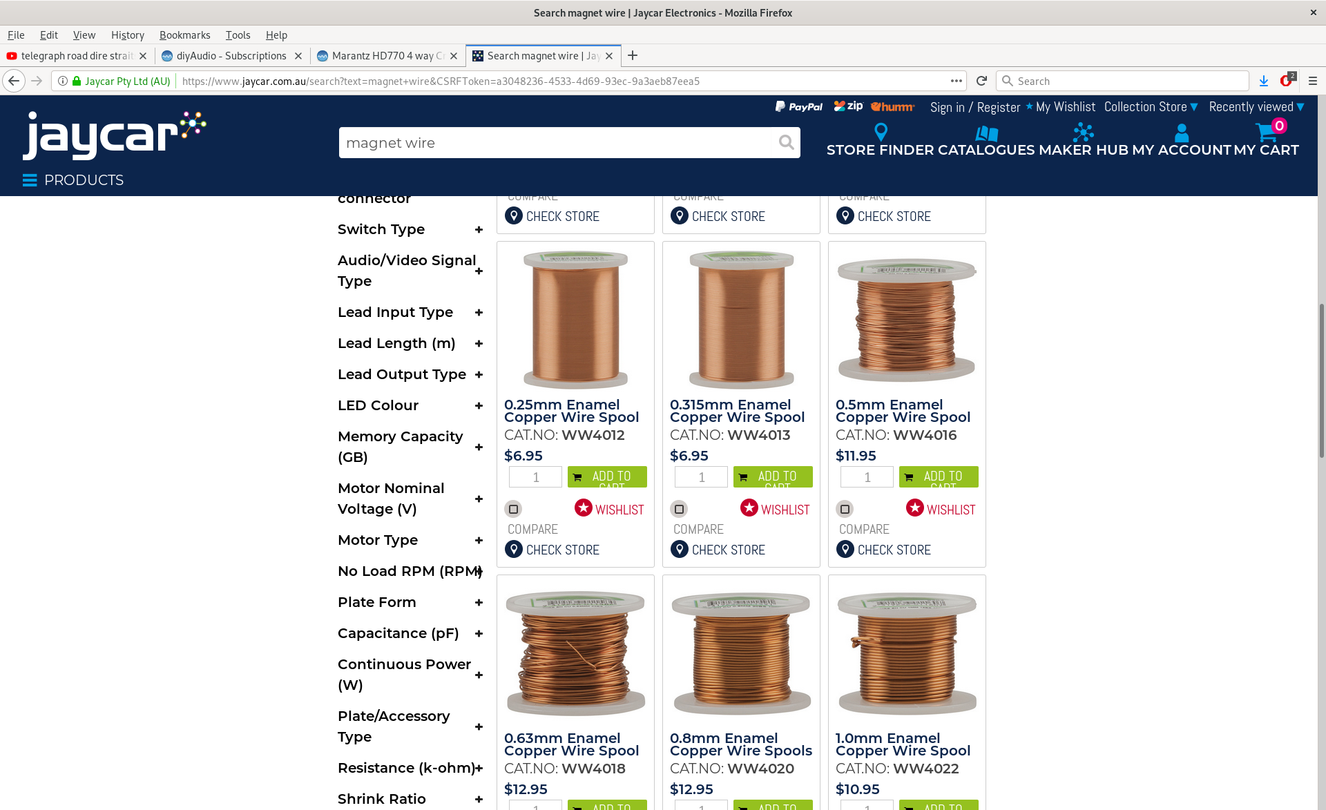

How much does awg 18 and awg 27 magnet wire cost in Australia?
Perhaps we can assist in doing your own coils. I am positive that with help of a coil calculator, we can predict diameter and inductance within a couple of percent from the original value. If there were any issues finding right magnet wire for the higher dcr inductors, adding a resistor in series would solve it.
Retail, that's 25ga and 19ga on the right, 57m and 14m in length.

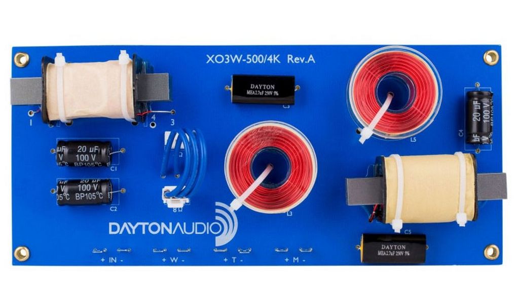

There is also the option of purchasing ready made cheap Chinese crossovers employing iron core inductors. Modifying these to meet the original marantz values would not be hard, some caps might fit also. The excess wire from one could be used to increase the inductance of another.
I have been sitting this 3 way thinking that I could modify the board for the 3 then just add one more for the last tweeter, do you think it would work?
