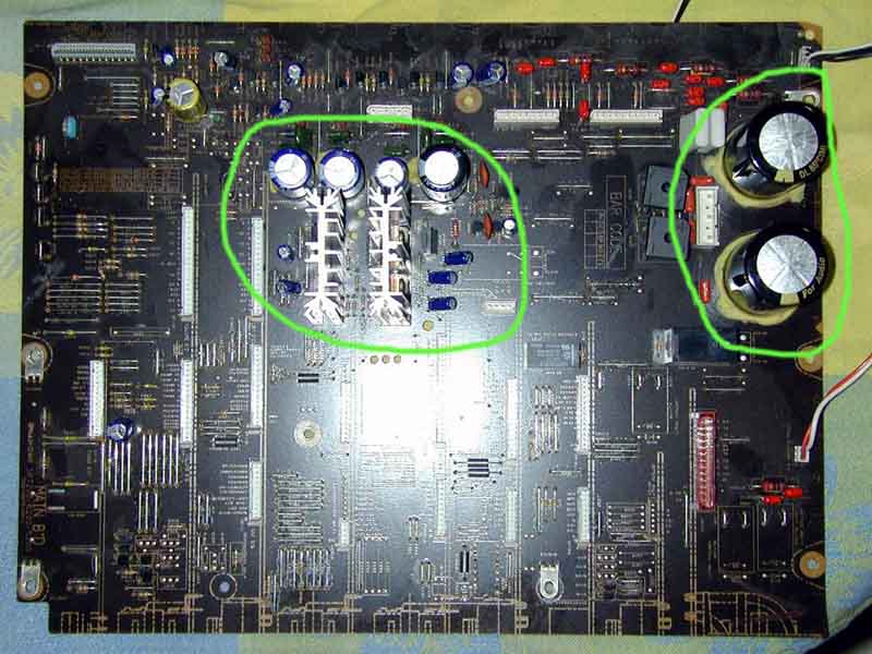

Here is a bird's eye of the main board, I have circled the sections I would focus in on. Anyone have any direction for me to go on this? I will post another picture of the transistors on one of the channels. I want to test the two huge capacitors to make sure they are both good. How do I test capacitance?
I think you are looking in the wrong places. If it's a 6 channel amp there should be 3 output module/chips at the very least (assuming 2 channels per chip). 6 pairs of transistors if modules/chips are not used. Where is the main heatsink? And what is attached to it?
IMO it's pointless looking at the PSU caps - if there was a problem with them it would affect all channels.

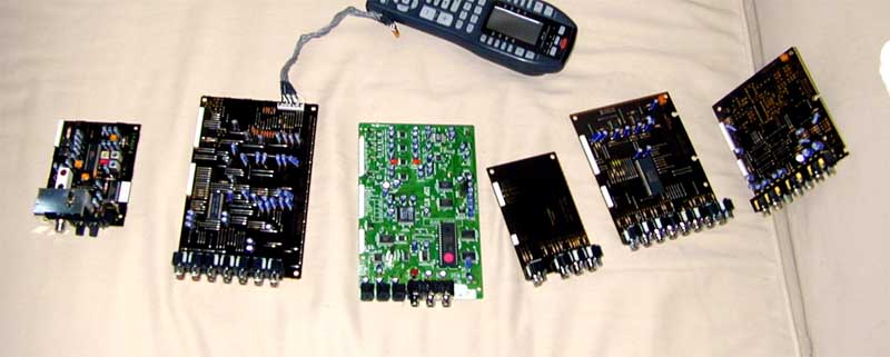

I think you are probably right. As you can see, I have removed all of the other boards from this mainboard so I could have access. Which board should I be looking at? I will post another picture after this one of the base unit with the main power supply.

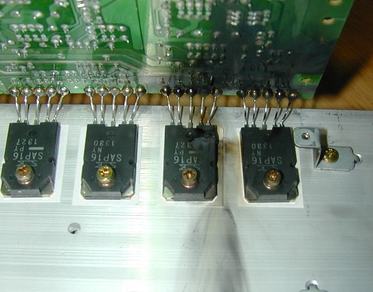

Culprit found!!! Low and behold I was digging in the wrong place (as I suspected). I put the receiver back together discouraged and ready to take it in for repair tomorrow but decided to check one last thing. I removed the transistor board and unhinged the heatsink to find two massive 5 pronged output transistors fried to oblivion. I tested resistance and got nothing on one and on the other some really crazy readings. I suspect (hope as well) replacing both of these transistors will solve the problem. That would be nice. One is labled SK SAP16 NY 1330 and the other SK SAP16 PY 1327. Each channel on the amp is set up this way. Does anyone know where I might find these transistors and how much they would cost?

Man that looks ugly. Too bad a commercial design of modern date can't
handle some hot-plugging.
The transistors have integrated emitter resistors so at least you don't
have to worry about thoose (unless they added extra externally).
Change the transistors and pray to god the presceeding stages are OK.
/ Good luck / Mattias
