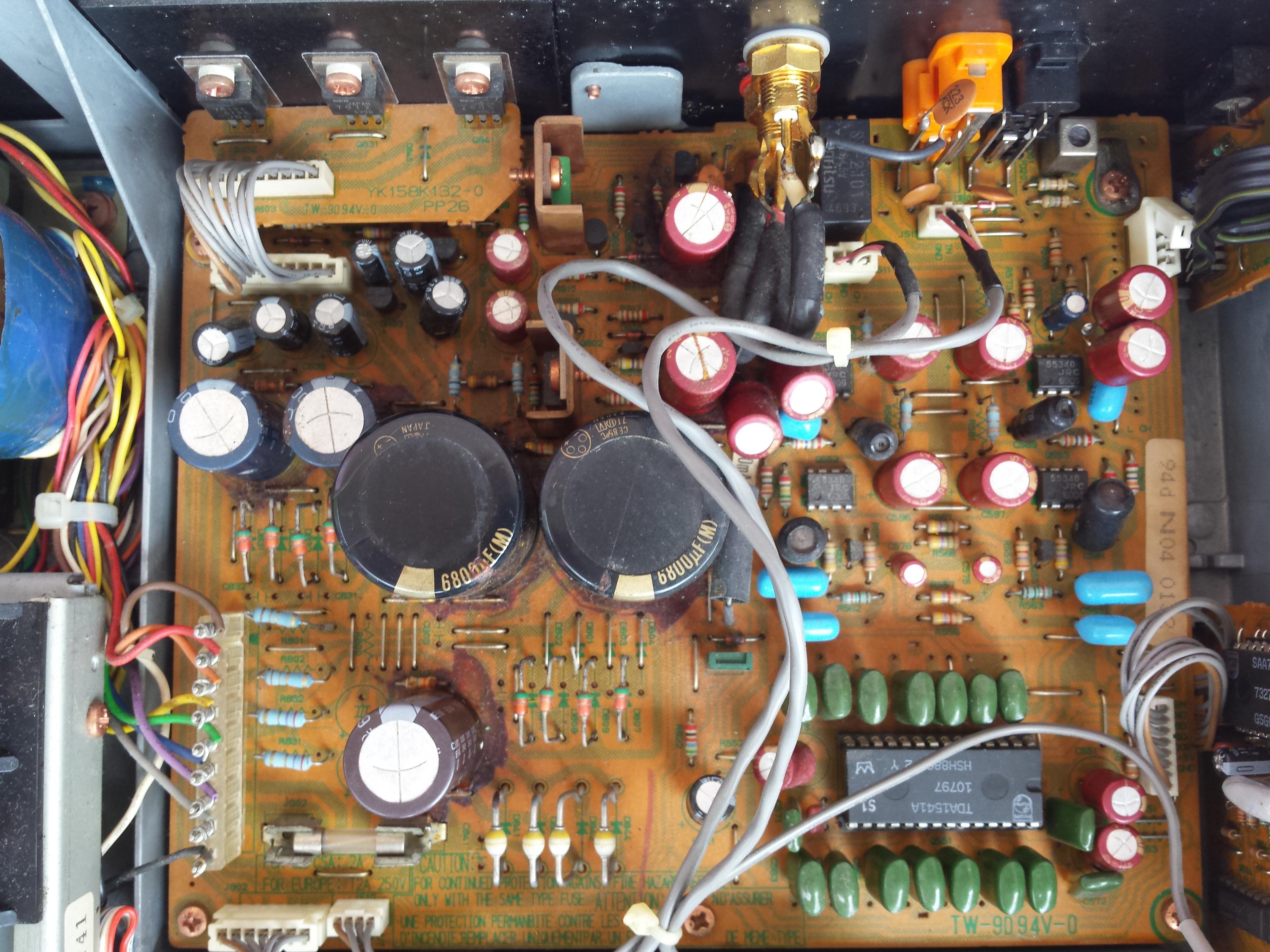

I don't own them, but I modified few CD94 MKII machines. Each had a 1541A S1 X 2 DAC combo. I also remember from my TDA1541 DAC days that "plain vanilla" 1541A DAC chips all sounded different.... this was easily noticeable. However, I was unable to find a single 1541A chip that sounded as good as 1541A S1's I found in 94MKII. I still have around 6-7 plain 1541A's... and one in S1 flavor.
Here is the single 1541A S1 in my 94MkI.
It seems it needs new ESRD8R2M16R decoupling caps, Grundig CD9009 DEM recloking and low ESR caps between power supply pins.
